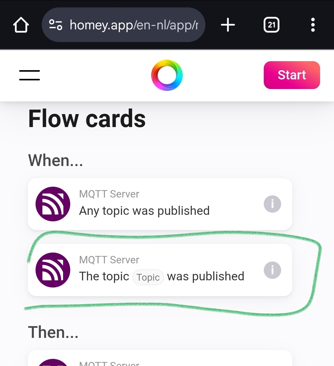

Well… it is. You wrote:
MQTT Server does not need MQTT Client and they’re unaware of eachother…
You’d use this MQTT Server card instead:
MQTT Client is part of the MQTT system you can create with the MQTT Broker ( & MQTT Hub) community apps;
MQTT Server app is published by Emile (Athom).

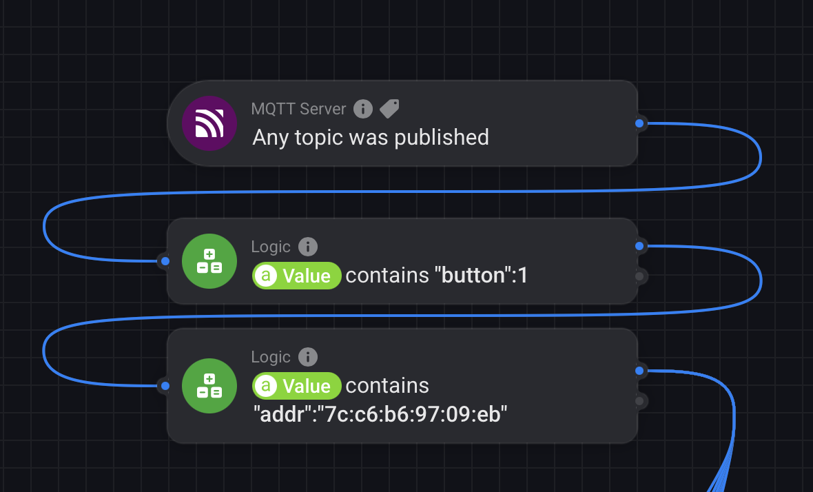

Hi, Thanks for your response. It helped me assure that the MQTT server application does not need the MQTT client application.
I also finally understood how to filter incoming topics using conditions. That was what I mainly didn’t understand. I didn’t know how to use AND cards for filtering. I understood that it is best for me to use the card Logic - Value contains…
I was a little confused by MQTT explorer, which listed individual details about my BT button, but in order to use it in the AND card, I found that I had to remove one space, otherwise it didn’t work. For example: Value contain “button”:1 (not “button”:(remove space)1).
Now it is working! :slight_smile:
