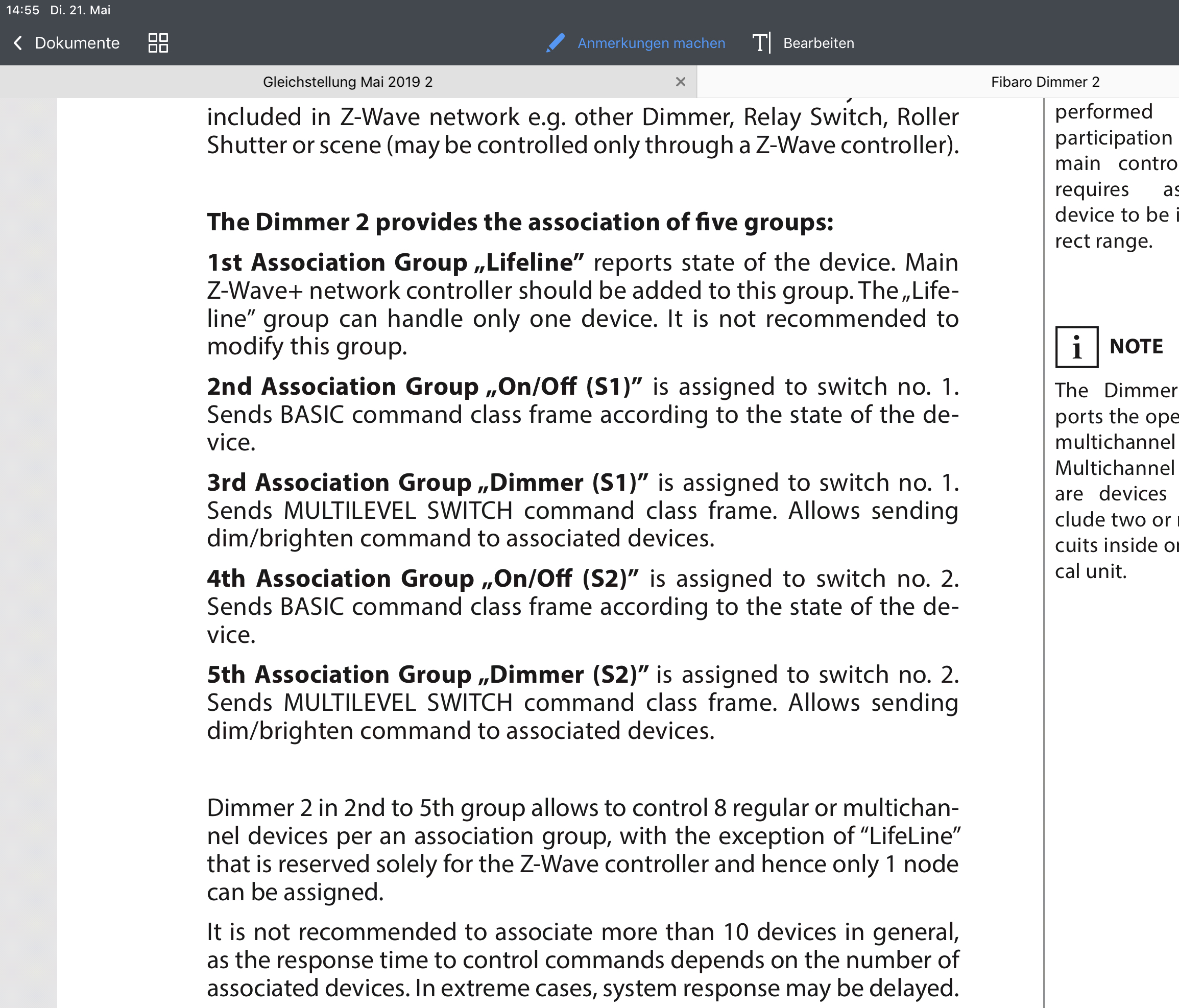

I would like to have a AEOTEC wallmote quad associate with a FIBARO Dimmer 2.
How does this work ? Where do I add / amend the node IDs in the settings ? Each device must understand to which device it has to communicate so I thought adding for example in Group 2 ( switches on/off ) from the sending device ( wallmote ) the ID of the receiving device ( dimmer ). And in group 2 from the dimmer the node ID of the sending device ( wallmote ). This does not work…

You add id of the receiving side only on the Sender. Receiving side, nothing needed.

You have to set the Associations in the Wallmate.
Depends what button you want to associate to the dimmer. Just enter the node-ID of the Dimmer in the right group.
Short before you save the changes you have to wake up the Wallmote!

Have you taken into account that associations that emanate from a switch only work when the connected switch is pressed and not when you switch in the app.

Edit: Looks like back report is needed. On the sw1 group 4 I’ve added sw2.2. On sw2 group 4 I added only I’d of sw1(without multichannel). This way they are both changing the state of each other. For now looks stable.
@Osorkon well now I’m experiencing the fact that you mentioned. In case I switch state from app they end up out of sync and two clicks are needed.
I don’t use associations, i only know how it should work. But yes it is only “one direction” it only sends an on or off signal (or in some cases the dim level), it will not receive the current state back from that device as that device can already be asleep again. (IE: battery motion sensor - motion activates -> Switch On switch, by the time the switch is on and wants to send back another signal, the motion sensor is already fast asleep again).
The receiving device doesn’t know what kind of the device it is getting it from.
