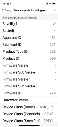

is the 82 in the picture the Node-ID ?
why there is a dot between 1.171 in your picture. (is now number one linked to a device 171)
What is number one?
How the switch know to dim (is one click or swipe up or down ?)
Yes
1 is homey and 171 is Smart Button.
In case of the Smart Button I Need an additional Association to homey. In this case “1,171”
See manual of Wallmote
