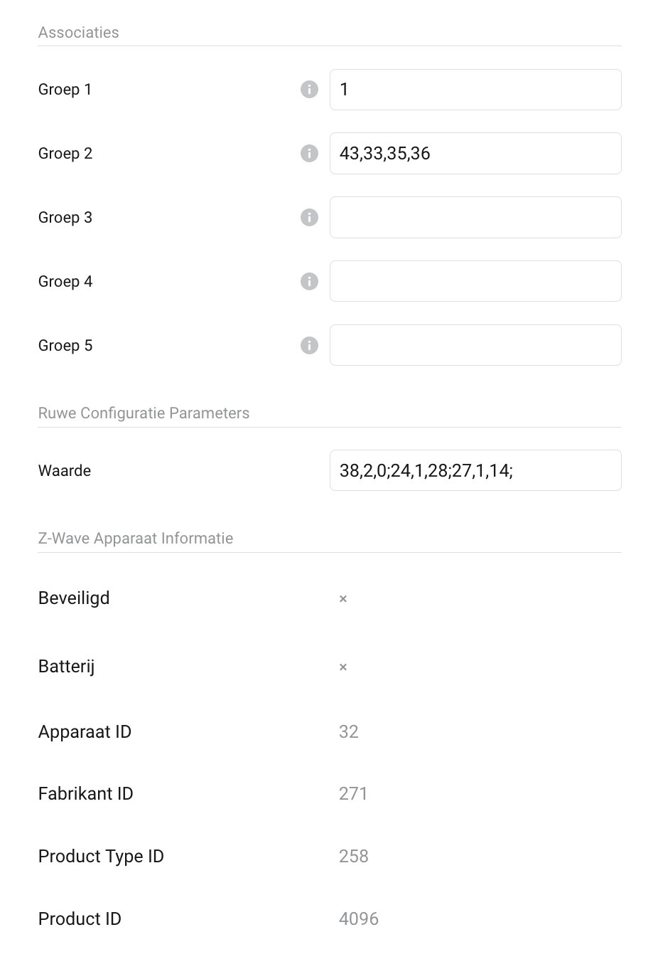

This is the configuration of the Dimmer with the physical switch:

I am sorry, I really don’t know anymore… I think by adding devices in association group 2, but I also see that I used some raw parameter settings on parameter 24 and 27. Not sure if that was related to this.
