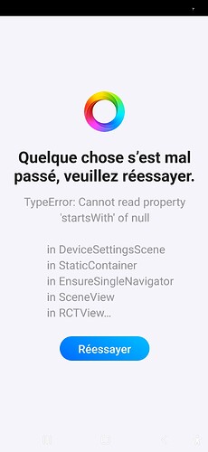

I cannot change the Aqara valve settings from within Homey pro. See the screenshot from the Homey app.
The web-app access the settings but it doesn’t affect the valve.
I try to switch off the window open detection function without success.
Thanks for your help!
This is a known issue with the mobile app.
Hi Robert,
Thanks for the feedback.
I’ve found a solution. I’ve put the valve back into Aqara Zigbee network and expose it as a Matter device.
Seems to work fine up to now.
It gives the advantage to easilly update and maintain the devices in their native environment. A drawback is that I need to keep the Aqara hub…
Regards,
Update: according to Athom, the issue has been fixed and they’re waiting for Google to approve the new release.
