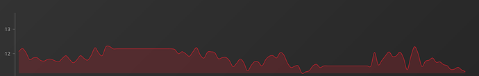

I’ve got one behind a glass door fridge as you can see from the two flat-lines. It can loose its connection for days … then be fine again for a couple of weeks.
For their price thought they are hard to beat.

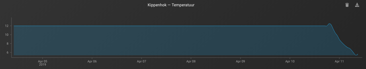

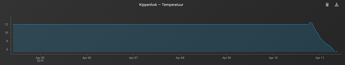

After reading this topic I went to check if my sensors were working correctly. The sensors in house are working just fine, also the one in the fridge. I did have a sensor outside in the chicken coop which apparently lost its connection since 12 days. I pressed the button on the sensor and it reconnected again.

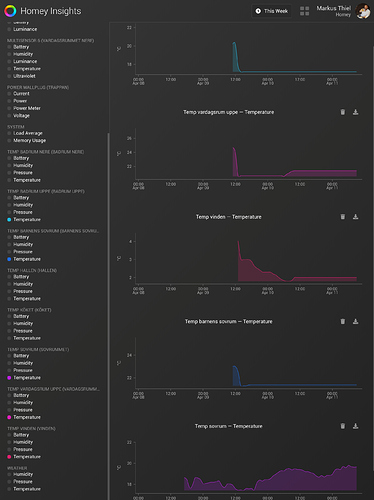

As you can see in the image the work fine at first… then they drop out… the only working one is placed in the room above the Homey unit… then the others are placed in other rooms on the same floor… about 4-6m between them!
