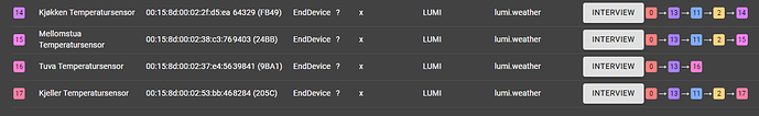

Hi, I do not know what to take a screenshot of but the sensors show the same temperature all the time, and in dev the seem to be connected correctly:
For each device Homey doesn’t seem to know what type of device it is (question mark) and the device isn’t online (“x”). So that’s not correct. My guess is still that they are dropping out of your network for whatever reason.

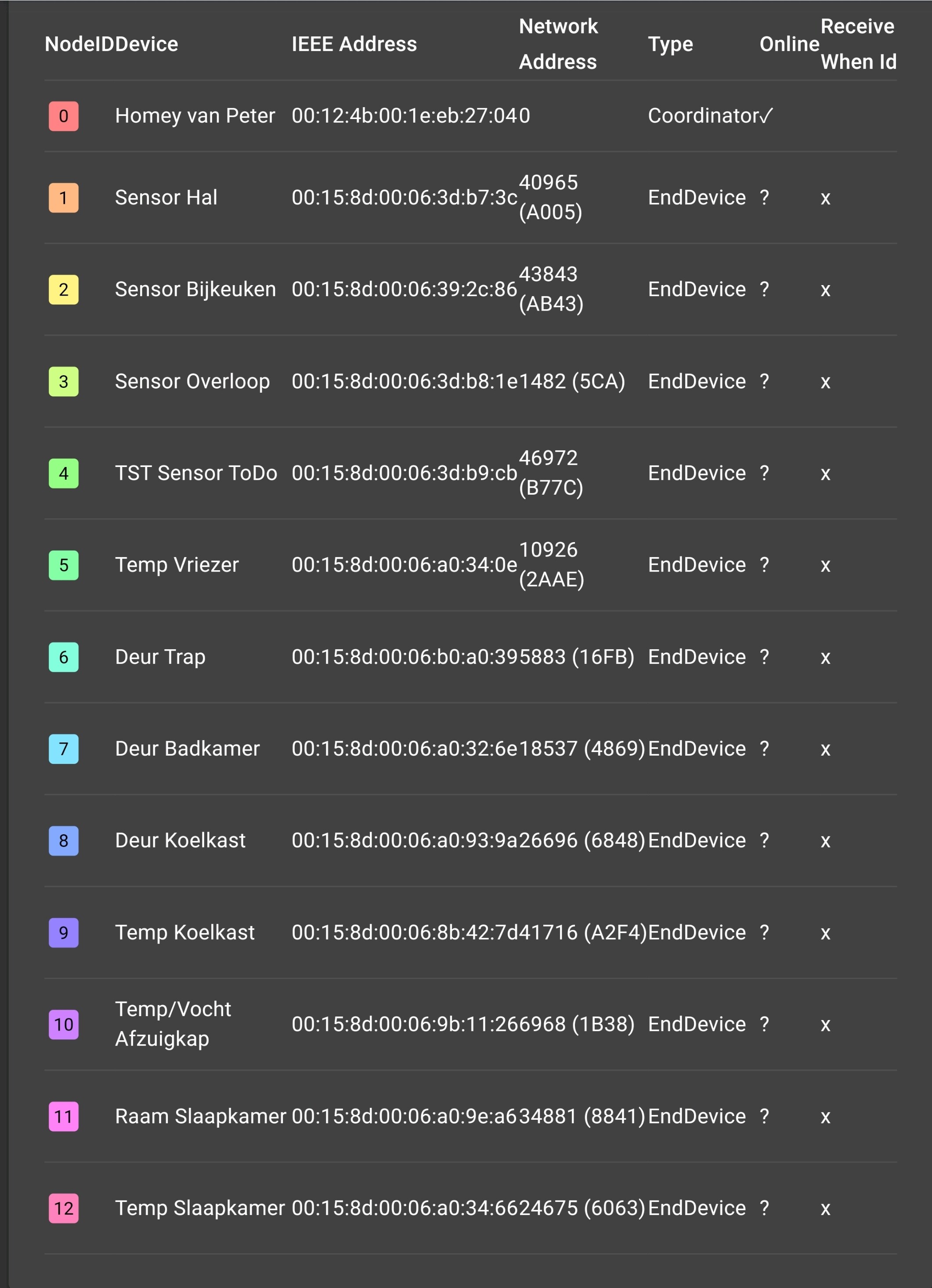

Your zigbee overview looks fine, here’s a screenshot of mine, to compare. I’ve no problems with it (all Aqara temp/pir/contact sensors).
The ? is the online state. While the sensors are in sleepmode, homey can’t determine their status. The x is about ‘Receive when idle’; don’t know what it is, but as the sensors go offline/sleep after a status update, they can’t be reached when they’re idle, like a mains powered router device.
Thanks @Peter_Kawa :slight_smile: I had to make a guess about the question mark and “x” mark, obviously I was wrong :sweat_smile:
YW Robert. But you had to do it without the column titles :wink: And you can’t peek @ developer site yourself anymore (If I remember well, you are a homeyless person :wink: )
