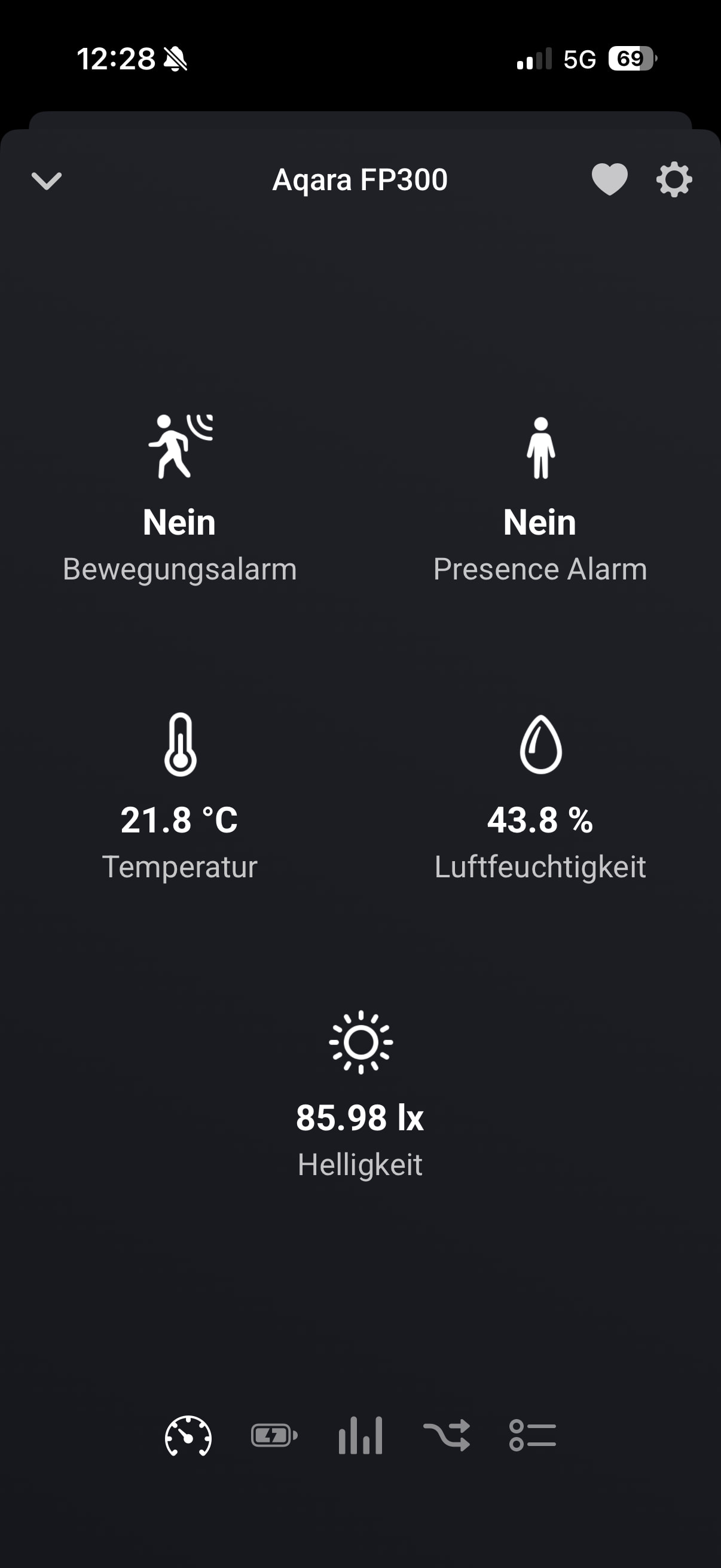

I think that this is where your problem lies. Due to a limitation with Matter, the sensor actually only has a single motion alarm. No-one really knows what logic Aqara is using to calculate the motion alarm value and whether the mmWave sensor is used at all. If you can figure out how to switch to zigbee, you will have much more control.

Using the Matter firmware, you’ll have less parameters. If you have a M3 Hub, it would be better to use Zigbee and add the M3 Hub into homey.
What you get on Homey Pro with Matter :
And without a hub but via Zigbee, you have the following options.
Yes and much more setting thru advanced settings in device level.

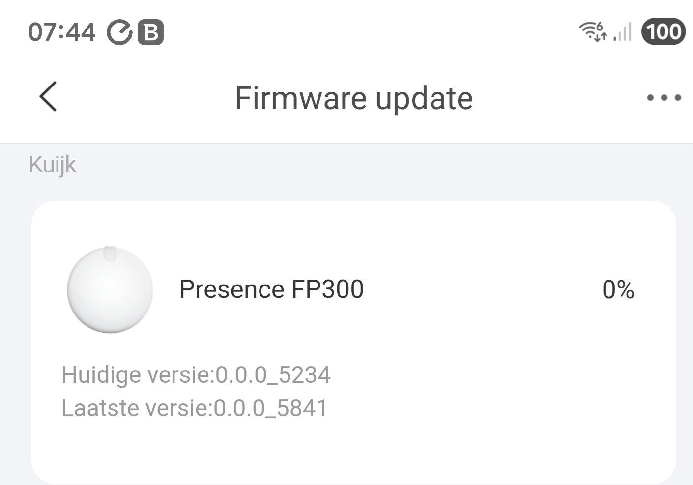

There is a new firmware update.
Only available via the Aqara home app. My device is connected with the Aqara hub M100. I do not know if this is required for update process. Another device is directly connected to Homey, but then you can not update.
Aqara does not give support if device is directly connected to Homey: “If it is used on a third-party platform without going through the Aqara hub, we do not support this method, and some unknown abnormal situations may occur.”
I have some issues, for example detection of movement every minute without person detected. Very annoying. Hopefully this is resolved.
I don’t see thy update
Also connected via the hub
Mine just arrived, I think a little bit patience is needed. (Or do you have auto update enabled?)
