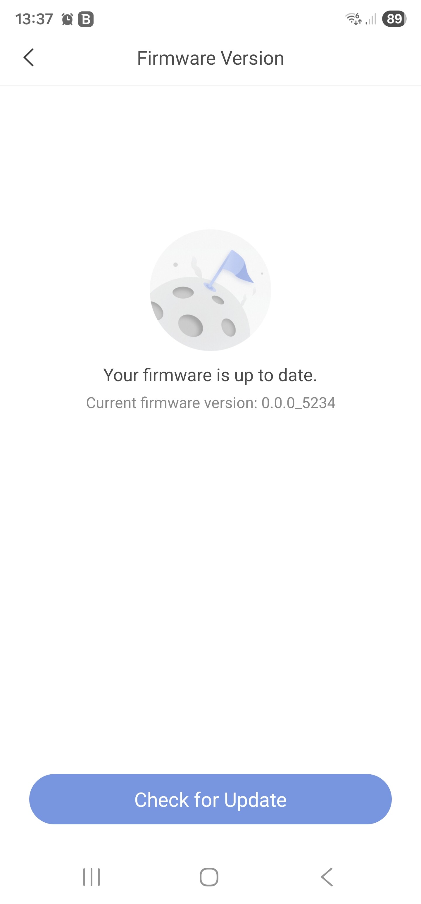

But to update the firmware it must be connected to an Aqara hub.
Are you sure?
No…
To switch from Thread (Matter) to Zigbee communication protocol you need the Aqara home app, but not (the device to be connected to) a Aqara hub.
Not sure if that is also updating the device firmware to the latest version as well (didn’t check that one my self)
At first time installation the zigbee firmware is automatically downloaded and installed no Aqara hub needed). But how to install new firmware via Homey? I do not have a device that can install firmware via Homey, exvept for Homey itself.
In the Aqara home app there is a dedicated button available.
That is currently not supported within Homey (for any Zigbee device / app).
As mentioned, I don’t know whether with changing the protocol from Thread (matter) to Zigbee also the latest Zigbee firmware is installed… otherwise that could be an alternative solution.
I’ll clarify on this topic with Aqara.
I can confirm the latest Zigbee firmware is installed.
