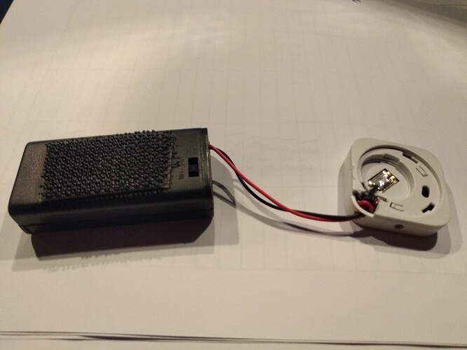

I also try to have my aqara vibration sensor in my letter box. I have about 22 meters from the last router device.
And not much is needed as I manage to pair the device sometimes. But then it loses contact after a while.
Please, stop commenting on my post when you can not add anything meaningful!
The idea was to be able to solder on cable to an antenna like this. But the question is where should I solder on it?

The battery is no problem! 2 st AA lithum :slight_smile:
