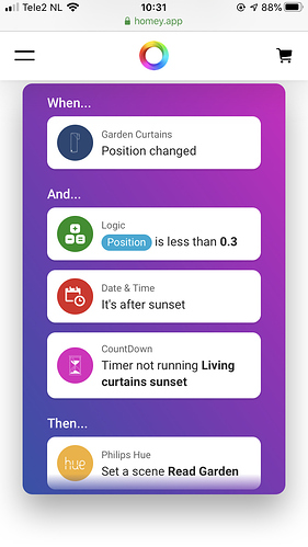

It’s not that I really need it to be at 100% (or 0% for that matter) but more that I can make flows that respond to a simple (WHEN statement) close (0%) and open (100%) command rather than having to hope that the current open percentage is updated (which can take minutes) with dodgy flows such as below;
If I create a trigger for open/close, it will probably not be faster. I check the curtains status every 30 seconds. Then pass the position through to Homey.
A trigger based on a status < 5% or > 95% will be equally slow.
