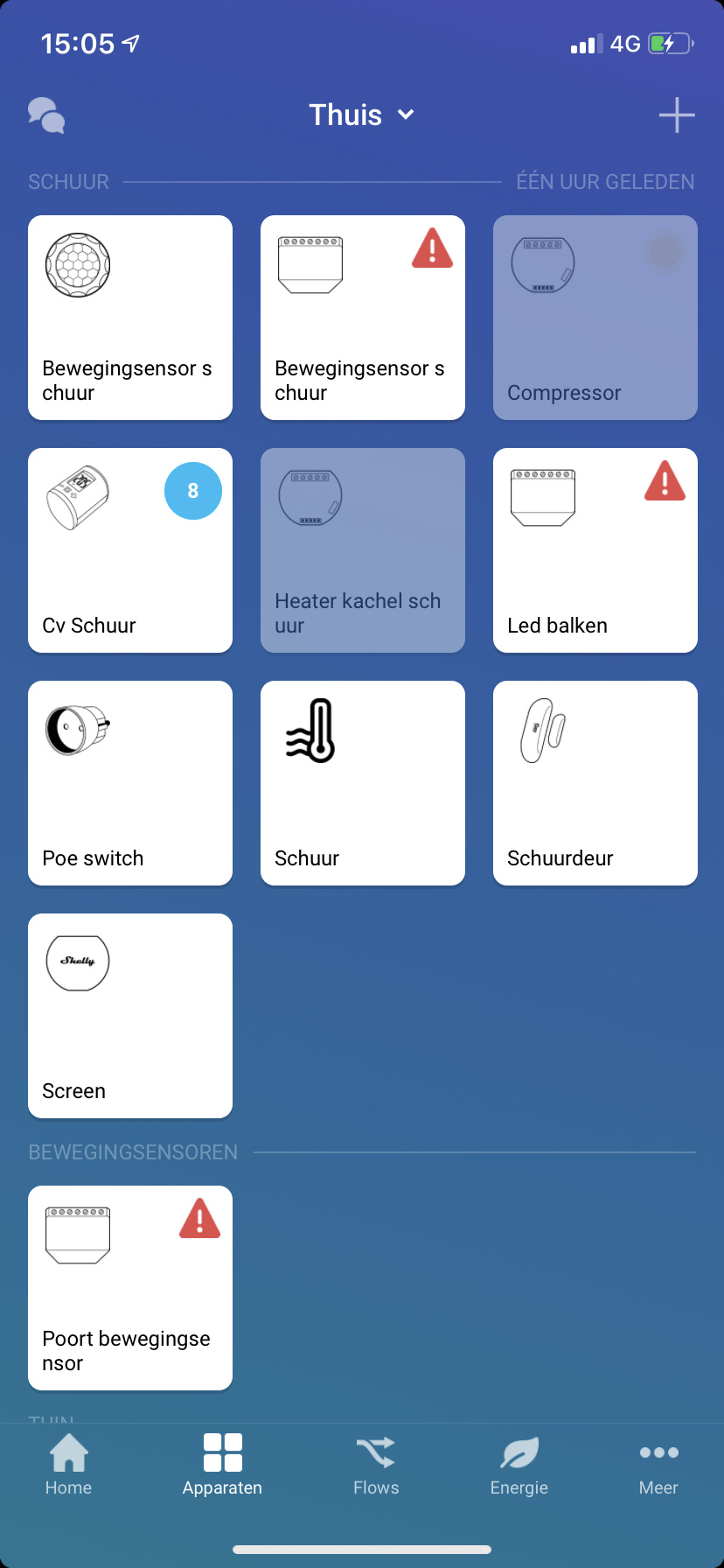

That is normaal the signal is perfect
Than I’m out of clues. As you are the only one having these issues I dont think it’s related to my app but it’s something in your configuration. If you know how to run apps from the command line I could create a debug version of that app that might give more information on what is happening. Just let me know if you want to try that.
[EDIT] I did find something that may cause the red triangle for the RGB2 White devices. I’ll fix that in a next release.
ok i have never done it but maybe it is something to learn i don’t like being alone so i would like to try
to solve it
v1.18.2 - 2020-0406
Bugfixes for RGBW2 White and the triggercard ‘Meter Power in Wmin changed’ for Shelly 2.5
everything that update means is so for certain devices every x goes wrong
it’s even so bad when i do shelly app restart it is homey half minute offline
Could you send me another diagnostic report once the app has restarted.
24aefb21-9628-4568-b0bd-2fb604ce8eef
There is something wrong with your network. Requests are timing out
