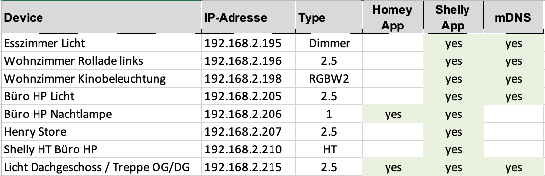

I looked at three first points:
IP addresses are assigned via DHCP and are reserved (= always the same address).
When I want to add a device, only 192.168.2.215 (already added) and 192.168.2.207 (is a roller shutter) appear under Shelly 2.5 Delay. With Dimmer and RGBW2 4xWhite Mode no device appears

I have restarted my WLAN (Huawei AC6005 Access Controller with 4 x Access Points AP5030DN) And afterwards all Shelly devices were visible in the Discovery App.
Afterwards I could add the dimmer, the RGBW2 and two Shelly 2.5 in the Homey App without any problems. The roller shutters were visible under Shelly 2.5 but could not be added as roller shutters.
This rather indicates a problem with the Huawei WLAN. I have already read about problems with WLAN in various communities. I have to investigate.
