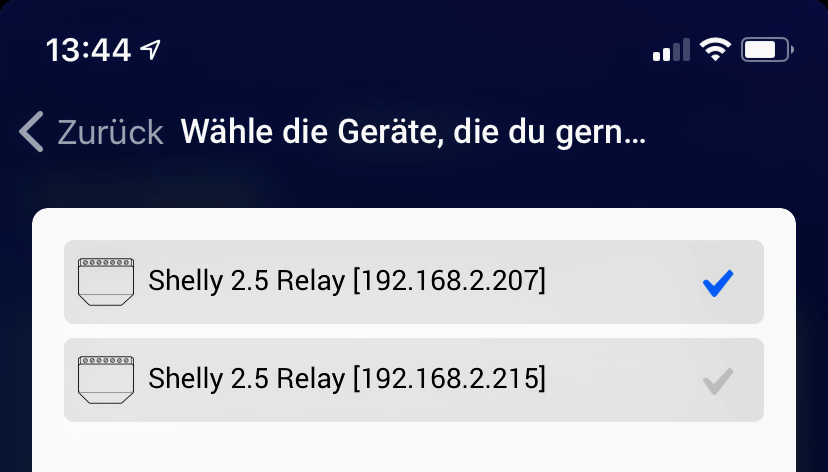

The topic with the detection of Shelly devices in the Shelly app has already been covered above. But I have the same problem. Currently I have the 8 Shelly devices (1 x 1, 4 x 2.5, 1 x HT, 1 x Dimmer and 1 x RGBW2) correctly in the WLAN and in the Shelly App.
I could add one Shelly 1 and two Shelly 2.5 without any problems. But it does not recognize the other devices. The 2.5 always shows the already added devices.
Restarting the ball did not help.
Could you run this debug version from command line and try to pair your Shelly 2 or Shelly 2.5 devices and let me know the output from the console. It also should not show Shelly 2.5 devices under Shelly 2 pairing wizard anymore.

I confirm that I have already managed to add my shelly 2 without any problem, and the shelly 2.5 no longer appears on the list.
