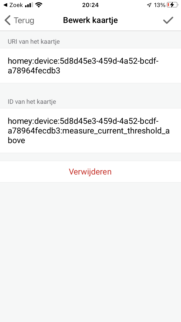

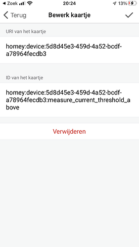

Hi @JPe4619 I wish I could select it, it’s just gone. I got 4 “unknown” devices, tried to heal those, but got the message “timeout after 30000ms”. Here is a screenshot
This post didn’t help either [HOW-TO][Pro][Cloud] - Tool to FIX (advanced) flows after removing and re-adding devices, couldn’t find the “ZMNHXD” or the ID “b1386d9f-21de-40e2-b4cd-dc38aee74ceb”, was going through the documentation, because probably somewhere I should be able to use Homey.devices.getDevices( ); to just list the device by using the id or the driverId, but I am spending too much time on this already, and I need my fuse protection, so I’m just going to re-add the damn thing and update my flows yet again and for now not going to add anything.
EDIT: And there it is again (I’ve added it again), probably all the unknow devices are the 3-phase meter:
EDIT: So to test this, I tried to add another Fibaro Door/Window Sensor 2 (I got 10 of them… 9 need to be added) and the 3 Phase Smart Meter (ZMNHXD) isn’t listed anymore in my devices and it becomes an unknow device in Homey Developer Tools which can’t be healed.
@QubinoHelp well, don’t know if it is the app or the Homey Bridge or the Cloud backend, but the fact now is: Once I add a new device, the 3 Phase Smart Meter (ZMNHXD) isn’t listed anymore in my devices and it becomes an unknow device in Homey Developer Tools which can’t be healed.
Very strange indeed.
Maybe it’s better to remove the unknown devices, you can do that in the three dots menu: “Remove”, if remove is gray, then use “Test”, maybe a couple of times is nessesary, refresh your screen afterwards.
