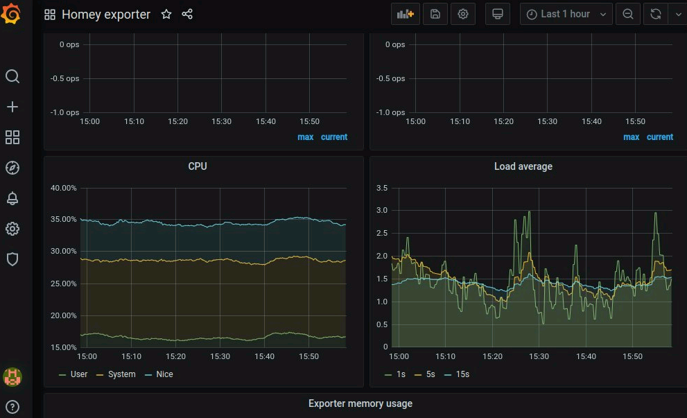

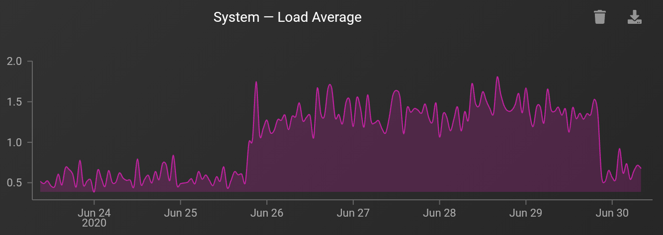

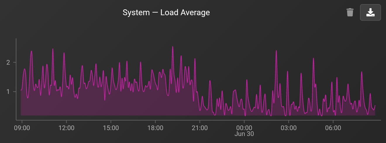

I see other people already reported this, but I only noticed yesterday that prometheus.io exporter is creating an unacceptable load on my Homey pro. I uninstalled the app around 9 pm yesterday, and the system load is significantly lower since then.
Anything you can optimize in your code to reduce the load maybe @Kyrcio? I really love your app, but it takes my average load above 1 :hushed: As you can see the app started working on June 25th, and I uninstallled on June 29th.
Could you please install dashboard 10586 and paste back what it spends CPU time on. I think last time I saw this, the physical storage of the Homey was slow due to a hardware or OS issue IIRC. The new polling should also be much nicer on the system so this is potentially a new issue.
I already de-installed prometheus. So I need to set that up again, including grafana to get the dashboard running. Maybe if I’m realy bored I will try that :thinking:
Edit: OK, I just got bored. Dashboard 10586 is running. So now what do you need from me?
Anything you want me to look at in the dashboard @Kyrcio?
The interesting graphs would be the ones showing what time is spent on, especially the systeminfo call.
Those remain empty (no data)

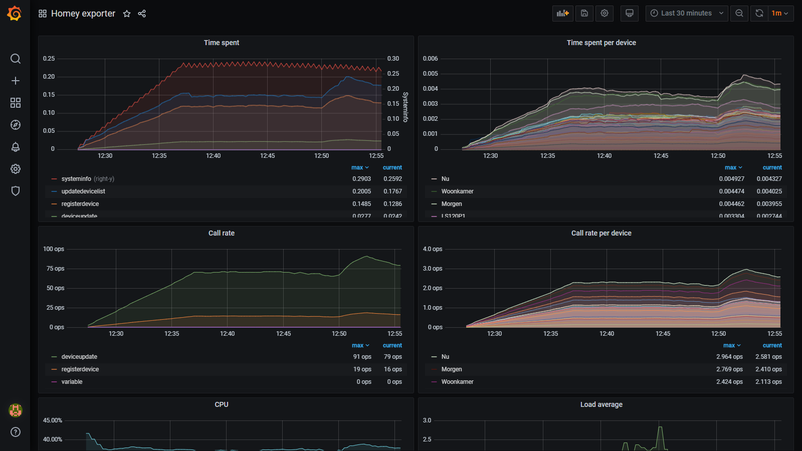

Sorry, I did not realize the old beta version expired once Athom changed the dev experience. New test version published here: Prometheus.io App for Homey | Homey
OK, reinstalled everything again with your test version. It is collecting data now.I shall post the graphs in some hours.
edit: this is after 30 minutes running:
edit: 3 hrs graph:
Hi @Gruijter
If i compare yours to mine, the time spent per device seems factor 10 higher. this was the case on my homey too, before the change below.

@Gruijter The problem here is that your Homey spends lots of time refreshing devices. Normally, updatedevicelist and registerdevice times should be more or less zero. I suspect that there is something (an app?) that cause the Homey to spam device changes events. Can you please create a diagnostic report for the Prometheus app and send me the UUID for it?
@matrover Actually, the system info loops looks quite normal. Of course it will always be a trade off between update frequency and system load. Note that this metric has its own y-scale in the chart, and that time spent does not equal system load (lots of async calls to the Homey APIs).
df243a78-2382-4593-895d-83e1237ad3bc
I only had the app running for 5 minutes when creating the report. Is that ok @Kyrcio ?
Thanks. I can see that the device update event is indeed triggered very frequently. I would have to add more logging to get a better understanding of why this is happening.
well, I have a lot of devices that each have a lot of updates :slight_smile: E.g. my power plugs update every 10 seconds, and I have around 30 plugs or so. And another 50 devices updating every minute. And then I have apps monitoring these devices and turning them into new virtual devices. like the PowerByTheHour app.
@Gruijter It is not the state changes that trigger device update events (https://developer.athom.com/docs/api/HomeyAPI.ManagerDevices.html#.event:%22device.update%22), rather updates to device metadata. I have created version 0.2.7 which improves logging (in addition to a larger timeout on device updates). Could you please try that and do the diagnostics report again? This should at least tell us which driver is the culprit.
