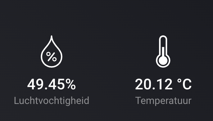

Just tried with mine:
One thing that may help is to remove the battery for 5 seconds or so, insert it again, then short the GND and Reset pins.
I must say it become one of the most reliable temperature / humidity sensor in my smart home.

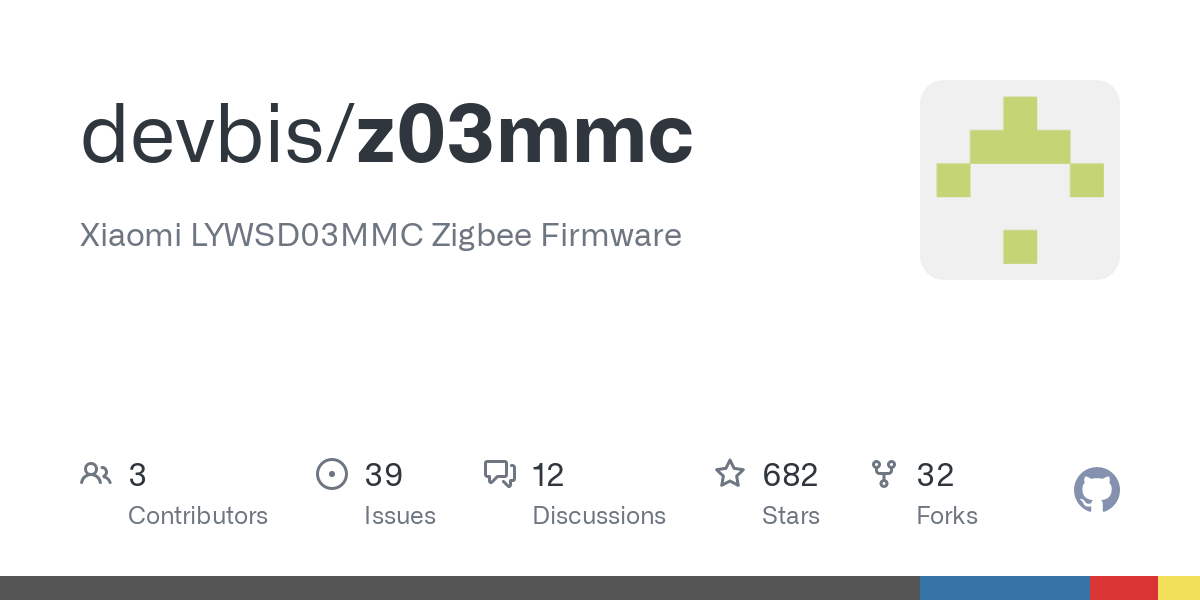

Thanks, that does make sense. I am having some trouble choosing firmware though; there are so many!
For example, I have found these:
Which one should I choose for the Homey app?
@Fisk, in this link you shall find all what you need.
Mine are running the devbis firmware. I assume that the pvvx firmware (which is easier to install because it doesn’t require an intermediate firmware) has the same Zigbee configuration, so should be fine too.
