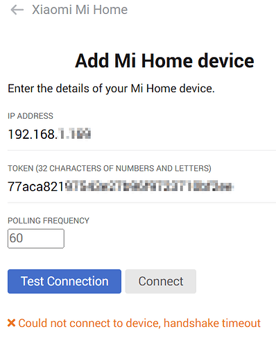

Is it not possible to add from both CN and DE server? I have most of my devices on CN server, yet my Air Purifier had to go on the DE server. - Same gateways.
I have both the Aqara Hub with FW 4.0.6_003 and the good old Xiaomi gateway with FW 1.4.1:176.0220 - Both set up in Mi Home app for years.
Everything from CN server discovers and conencts perfectly, yet the Air purifier from the DE server gets handshake timeout.
Devicename is there, tokens and IP address is there, but handshake times out.
Could server is not related to local control over MIoT protocol. The Zigbee hubs are also unrelated to WiFi devices.
Handshake error means there is something wrong with the token. Reset the device and start from scratch to obtain a new token.
