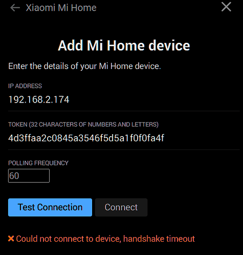

Hi, thanks for doing this! I think its a good way of adding things with token.
I have added my vaccuum and fan2, but im struggeling adding my pet Xiaomi Water Fountain from the china server.
Any idea?
The error suggests your token is incorrect. Try resetting the device, reconnecting the device to your WiFi and obtain a refreshed token.
