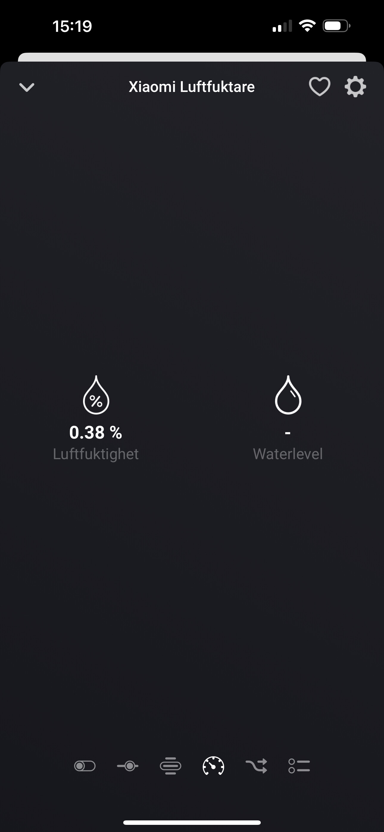

is there a way to correct the humidity value on the ā€œdeerma.humidifier.jsq5ā€ it shows 0.38% when it should show 38%
The target or measured humidity?
it is the measured humidity
I’m a bit hesitant to change it as various documentation sources tell me the source should already be supported as a value between 0 and 100. I havent heard anyone else about this. Could you submit a report on Github.
I can see that it should send something between 0-100 but could it be that it send the decimal value for %
this is what I see
<img width=ā€œ340ā€ height=ā€œ717ā€ style=ā€œwidth:3.5416in;height:7.4687inā€ id=ā€œBildobjekt_x0020_2ā€ src=ā€œ//cdck-file-uploads-us1.s3.dualstack.us-west-2.amazonaws.com/flex025/uploads/athom/original/3X/8/b/8b4a8523ea538c25d72b24f1735ccda504337939.jpegā€ alt="En bild som visar text, skƤrmbild, diagram, nummer
Automatiskt genererad beskrivning"><img width=ā€œ331ā€ height=ā€œ718ā€ style=ā€œwidth:3.4479in;height:7.4791inā€ id=ā€œBildobjekt_x0020_3ā€ src=ā€œ//cdck-file-uploads-us1.s3.dualstack.us-west-2.amazonaws.com/flex025/uploads/athom/original/3X/b/d/bd6cd6a2a10b5587c0e70d7a0fee1cd93e5b770a.jpegā€ alt="En bild som visar text, skƤrmbild, design
I have submitted an issue on Github
