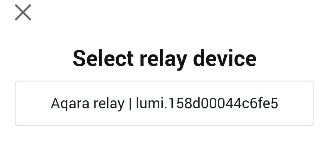

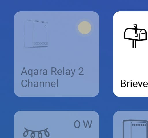

Some screenshots showing the ‘Aqara Relay 2 Channel’ or the “lumi.relay.c2acn01”
added in Mi Homey and not found in Xiaomi Mi Home. I omitted the gateway selection screen that is showing in the Mi Homey app but I do believe this is not crucial.
A diagnostic report might not be of any assistance since there is no error. Please let me know if you need more information.

In this test version, the relay isn’t showing and power plugs lost functionality. For now.

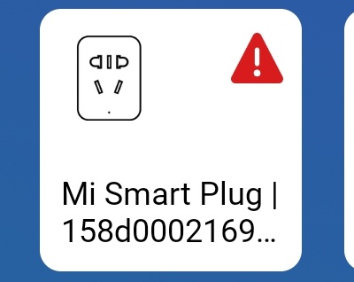

After repairing it shows an error:
Screenshot_20230310-074951__01
