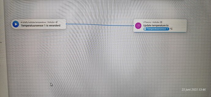

i have a : shelly 1PM gen4 + addon, and the themp from the addon need te be the temp the Vthermo uses. but how can i set that?
i already tried to make a virtual sensor device with the app device capabilities but that device he also not recognizes.

Just make a flow to set the temp is what i did after houres of search
