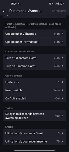

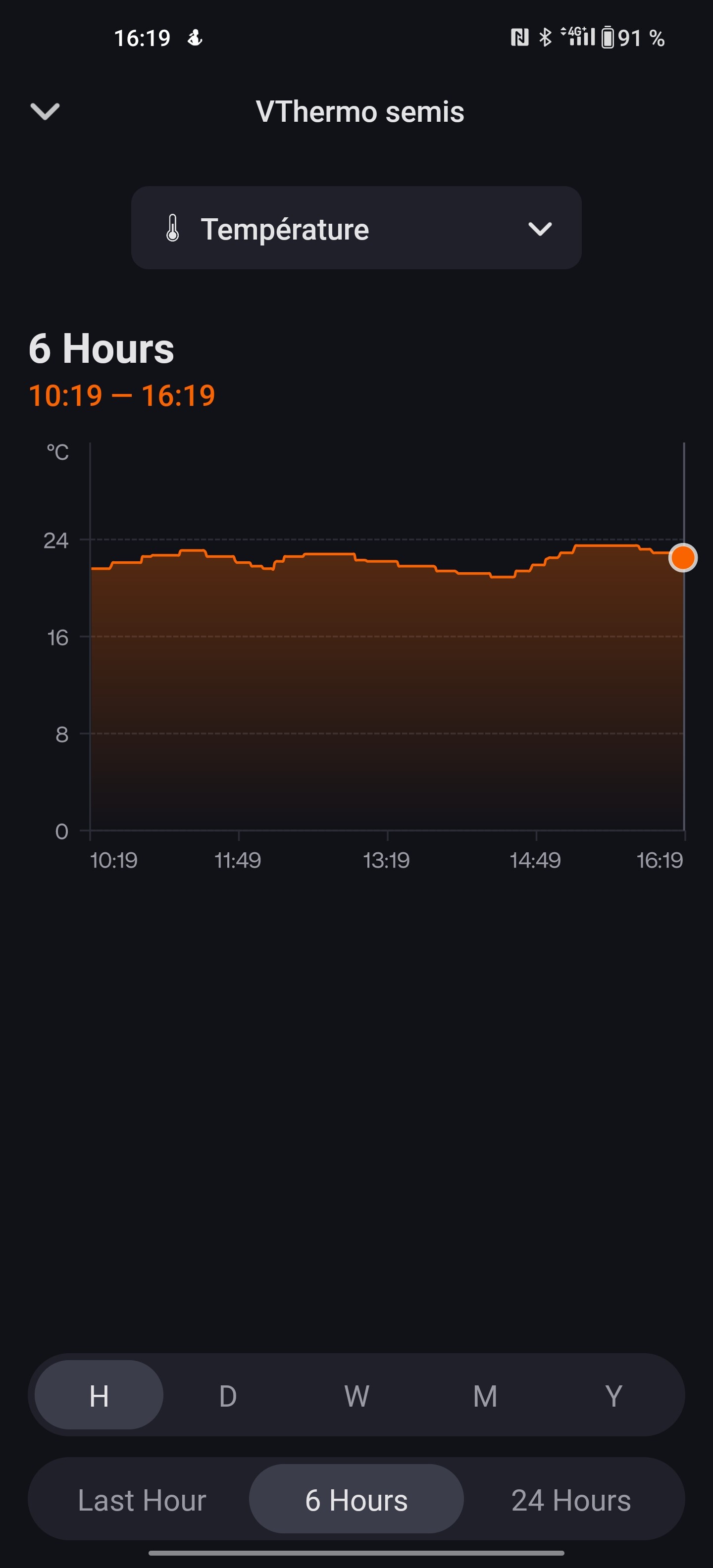

I’m using VThermo without problem with my 2023 Homey. It’s great! VThermo is V1.10.4
I’ve got a little problem with energy graphic within VThermo. Which is always at max consumption (70w) ; even when heating is turning off, graphic is still in high position. I thought it use to be low (3w in my settings).
Any idea?
Thanks a lot
I answer to myself. :face_with_monocle:
When VThermo is disactivated, graph goes at down position.
So my question : what is expected?
Graph goes at down position only if VThermo device is disactivated.
Or
Graph goes down when VThermo device is activated AND heating is off.
Thanks for your help
