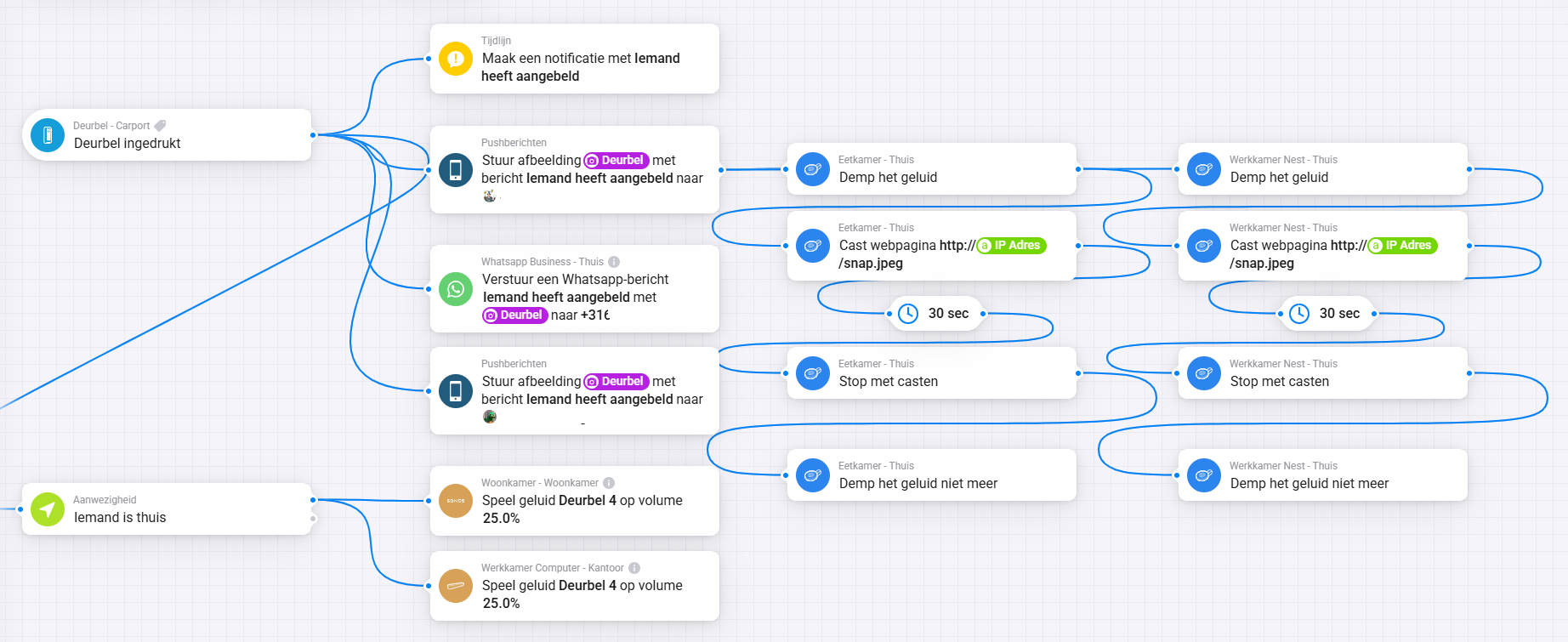

Since my last two updates to Unifi Protect, my Flow for the doorbell no longer works.
When the button is pressed, music should play on the Sonos. When I test the Flow, it works, but when I press the button, it doesn’t.
I’ve restarted everything, from Homey Pro to Unifi, but to no avail. In Homey, it indicates it’s connected. The app also displays the images normally, but the button press doesn’t go through, although I do use the Unifi app. Strange.
