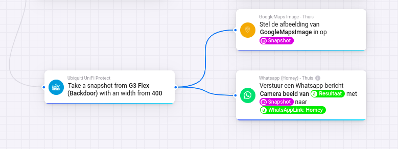

I was wondering if it is hard to make this card “taggable”?
Screenshot from 2024-10-08 21-31-17
So instead of the drop-down, I would like to use a tag from a previous action (that retrieves either the device.id or device.name).
Hope to hear from you!
I fixed the “taggable thinggie” with the following homeyscript:

but I can’t get a valid image when choosing “UnifiProtect → Snapshot”. Is that broken?
BTW: I do see the images is created in Homey Developer Tools
