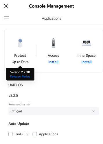

Hai, my version; Protect 2.9.32 thx in advance

What is your Protect version?
