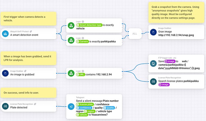

I’m having a issue with the snapshot image quality, the snapshot in Homey seems to have very high compression loosing accuracy for example for license plates.
When taking a snapshot from directly in Unifi Protect, the plates are readable and the file size is bigger which would make me believe that the compression rate is lower.
Is there a way to improve the image quality for snapshots in the Homey app?
Workaround: Enable anonymous snapshots on the camera local settings page by accessing http://camera-ip/ user ubnt / pass is the recovery code available in Unifi Console / Protect / Settings / System.
Now it is possible to use Image Grabber to fetch a current snapshot from http://camera-ip/snap.jpeg. The image is then at highest quality and full resolution.
So my flow is now:

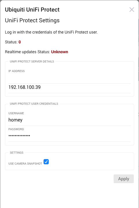

i can’t get it to work.
only a “please set the cloud key” message when trying to add a device
i’ve tried:
https://192.168.100.39/protect/dashboard
192.168.100.39
192.168.100.39:443
what would be the correct syntax?
User is a read-only user with all rights.
Cloudkey is:
UniFi OS 3.1.14
Can you make an screenshot from your settings page?
sure
protect:

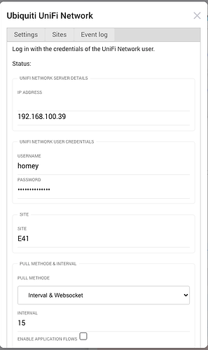

E14 is your Unifi site?
yes, but makes no difference if site is empty or “default”
message: Error: Cannot read properties of null (reading ‘getSites’)
You didn’t fill in the lines properly!
See my settings underneath, upper line is for IP adress, lower line for the port. And uncheck the camera snapshot.
OMG. me stupid… you are right and it is working now. THX!
