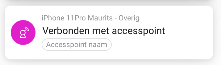

As of today i cant select an AP in the “laatste verbinding verbroken” (last connection ended) option in the “if” part.
I got several flows with this option in the “if” part. Wanted to make some other flows with it, but i can’t see my AP’s to select from. I tried to restart the app a couple off times now, still no luck.
Anyone else with this problem?

@ObelixNL Hi, Can you maybe add the Dream Router as a acces-point in the app?
In the card “Connected to Accesspoint” it shows only dedicated AP’s but my Dream Router is also an AP.
Thanks!

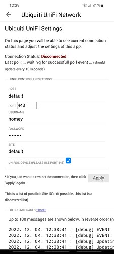

After a complete reset from my homey I’m having trouble with the connection to the udm.
The connection succeeded every time I use the connection button but after a few seconds the connection is lost. The update function doesn’t work. I tried the old and new beta app and both have the same issue.
What am I doing wrong?
Homey runs on 8.08
Unify control 7.3.76

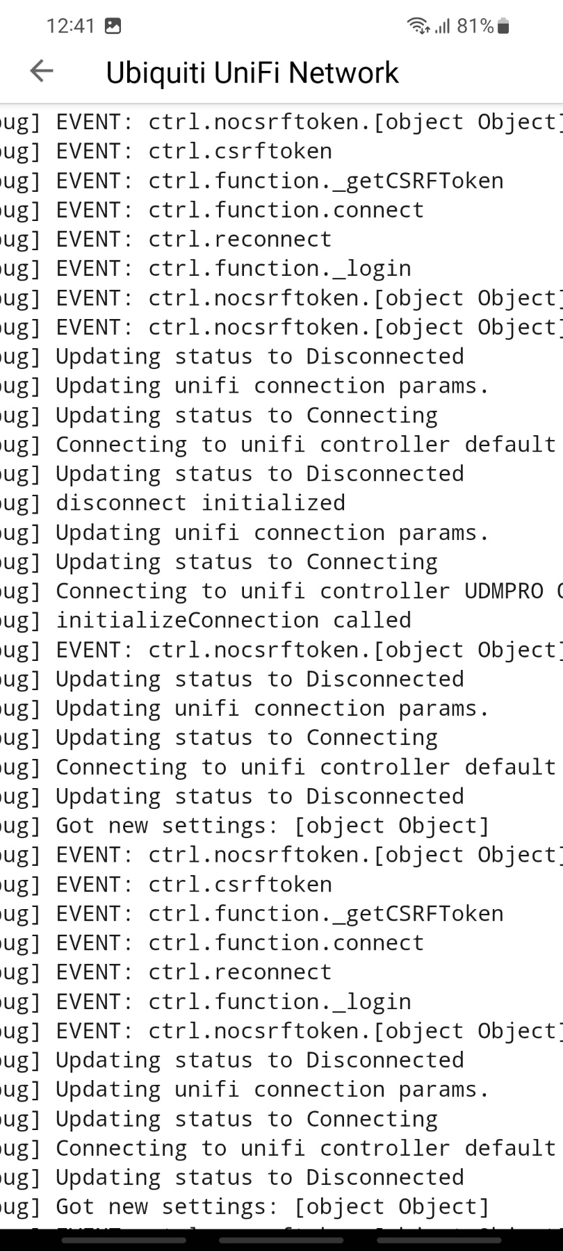

I also have some trouble connection to my UDM-Pro. It briefly says connected and then disconnect again.
There are some “Unexpected server response: 404”. Anyone else that got this issues?
Unifi Network: 7.2.95
Unifi OS: 1.12.30
Thanks
Looks like wrong url? do you have tested the new test version already?

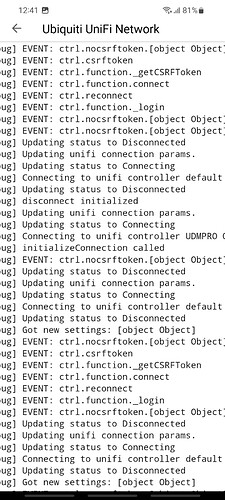

I’m trying to set up the app for the first time.
Done as local users admin, throws the following message and disconnects
what could be the problem?
homey pro 2019
6.11.10.1027
UDM Pro v1.12.33
Restart the application or Homey and check again. Otherwise your up is not reachable from Homey network of invalid credentials
I see that your host is default there must you enter the ip from the dreammachine
