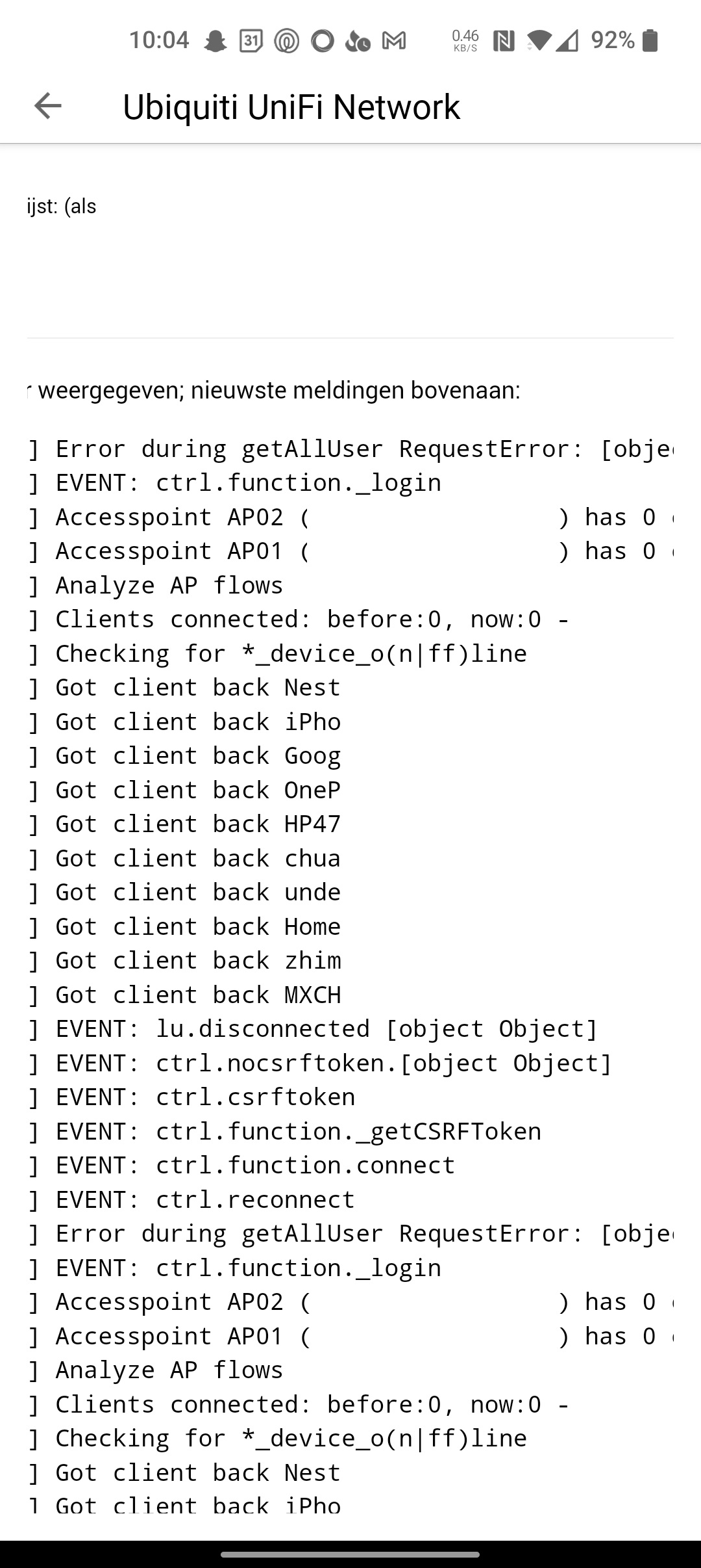

I have setup the Ubiquiti Unifi app on the Homey. I created a new (read-only user).
When I try to setup a new device for wireless it works straight away. But when I want to setup a wired user it will give me a error. I’ll attach the screenshots here. Hopefully somebody can help me out.

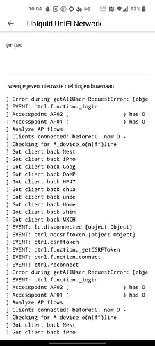

I am having the same problem. I consistently get Invalid x-csrf-token header, and don’t get any further than that.
