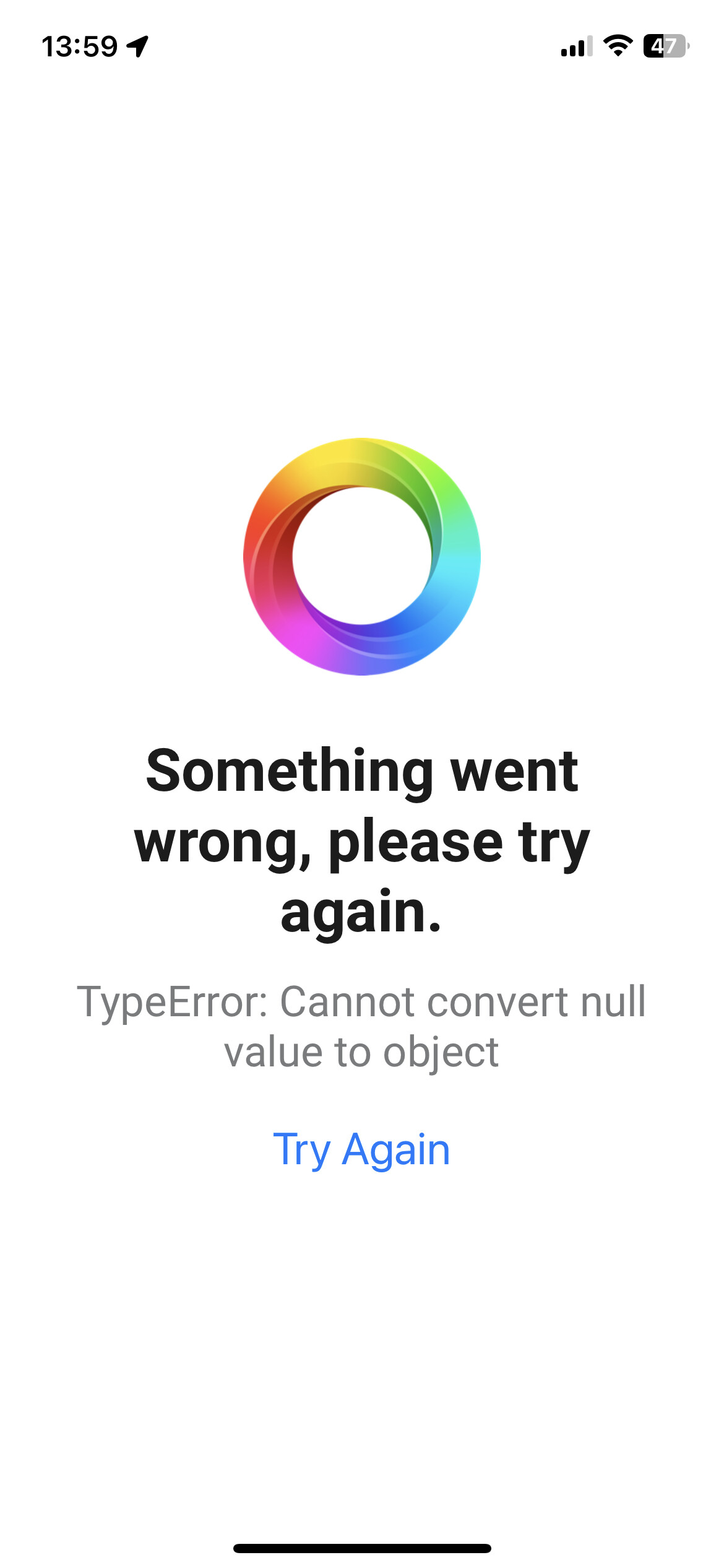

I’ve reported this issue. Is indeed a Homey app issue, Atom is working on it.
Yes, I got a new version in Testflight today and now I can open the Ubi app again, great.
