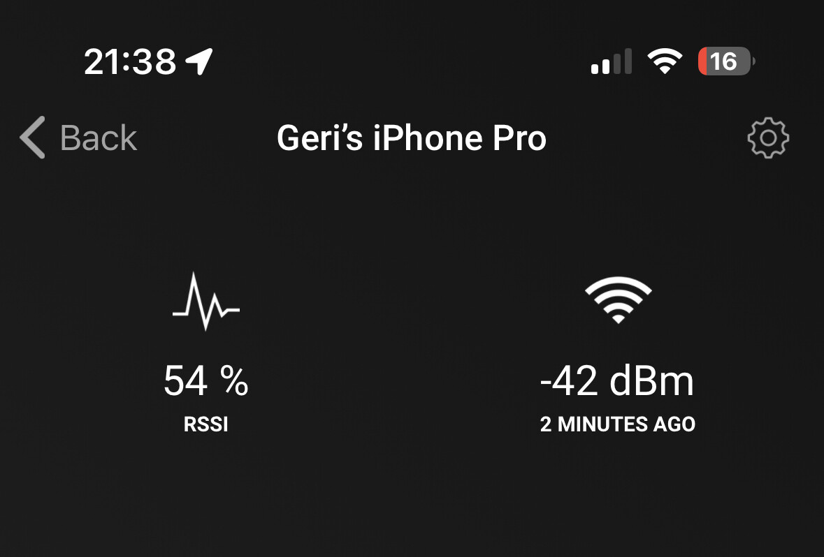

Test version has just landed on my Homey Pro. Thanks for it. For now only one feedback I have. RSSI is definitely wrong. One of my devices has -42dBm signal what was above 90% RSSI in previous SDKv2 based app, and it’s true. It’s outstanding signal level, while the SDKv3 based app indicates as 55%. Does your app any calculation behind this ?

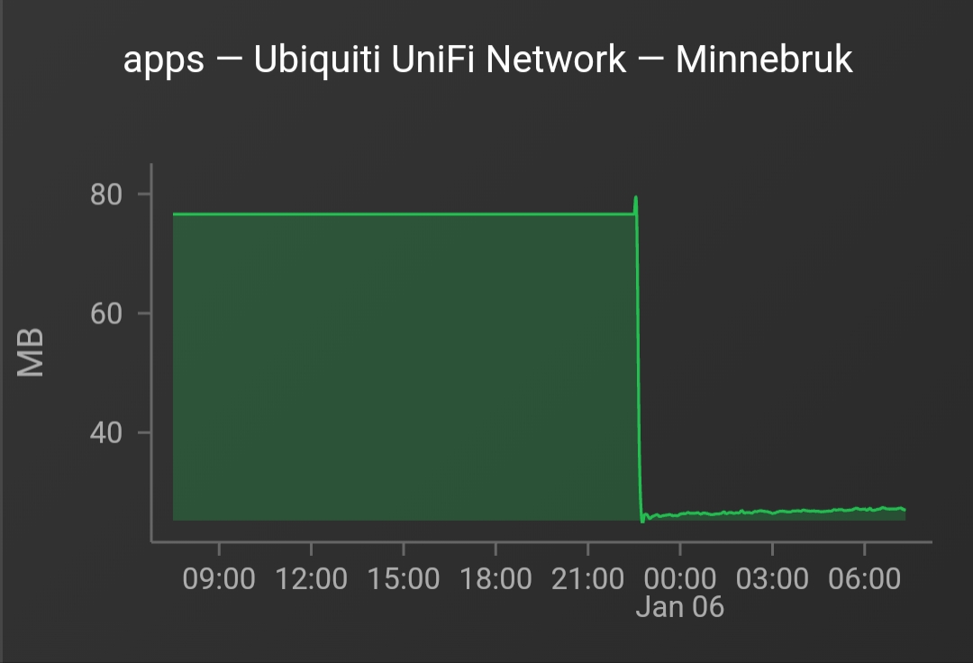

Just installed the new version last night and so far it looks good in regards to the memory issue. The drop in memory usage is from old version to new version.

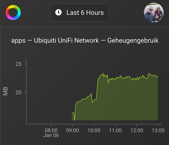

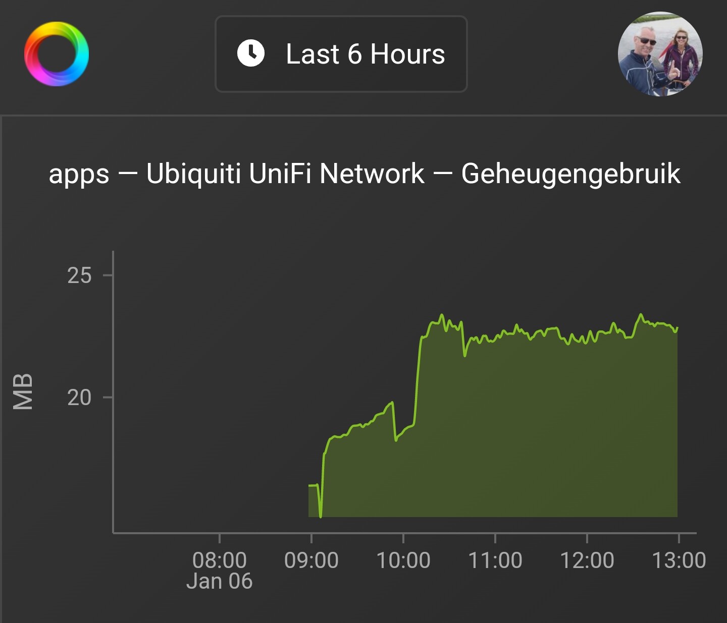

The app works now nice and fast, only in contradiction of @Leif81 experience the amount of memory use is way higher as expected and hoped for.

The old version has an calculation, the new version gets his data from the api. I must be the same as in the unifi portal.
UniFi portal does not show any percentage as RSSI, only “WiFi experience”, but it’s a completely different thing, and does not mach to the value I can see in Homey. (82 vs. fourtysomething) The calculation was right in the previous app. You can leave it as it is, but in this case it would be better to remove, because it’s false data.
