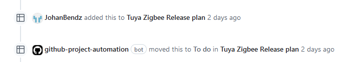

what status do I have to look out for to know its in the test version?
Fist the issue will be closed, then a new version will be created and it will be added to the list in the first post.
