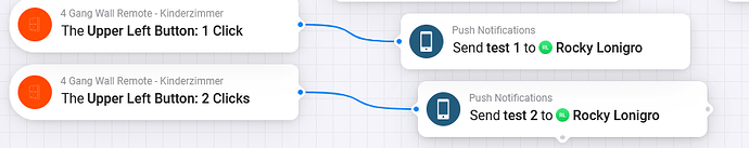

I added this thing: https://cdn.shopify.com/s/files/1/0095/4079/6497/files/battery_powered_light_switch.pdf?v=1716713547
I guess it’s not supported yet as I was able to add it as 4 gang remote thingy, however I get only 1 click 2 click and no long press option and when I test it for every thing i click i get 2 triggers instead of 1:
so when i click i get 2 push notifications
