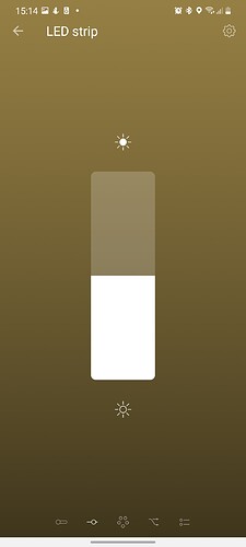

Installed Tuya cloud app and using that I can add the lights strip, but can only select white balance, no colors.
Am I doing something wrong?
I also did try the Tuya app and retrieve the settings there. Although I am doing everything correct, it doesn’t see it as available.
