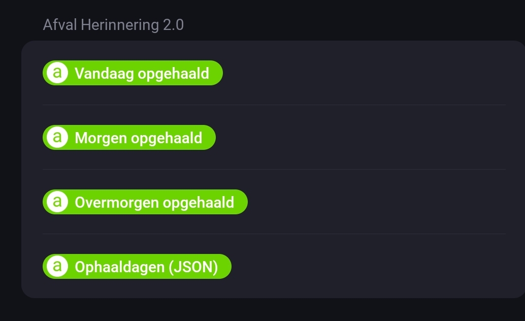

In the new version i’m missing the three cleaning tags
What do you exactly mean that you are missing the cleaning tags? Have you tried rebooting the app and Homey?
Er zijn alleen variabele voor ophaaldagen.
De variabele voor schoonmaken zijn er niet.
Zie afbeelding.
Waarschijnlijk vergeten te implementeren in de app.
No, didn’t forget. It was intentional. For cleaning data there are seperate flow cards (advanced flow) that will give you output tags per type collected. That is way easier to build flows then with the global tags + saves a performance penalty :slight_smile:
