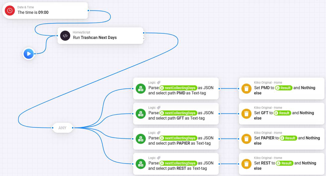

And finally make an advanced flow that runs daily and fills the labels with the right values:
[tef:FLOWS:"H4sIAAAAAAACA8WWW4vbRhTHv0oY8rhTZkZz1VvoJmkpLSHJ22LMmZujxraMrYQ12/3uPSPJu7GjggqGNVi2pZlzzv93LuMH0pH6gYR28wt0X/CK73Q8hH2z6x9sSU1+K7c+DbduhvXbdN/92q7XKXTNdnULx8Np8cSTfg85dHu8QR7xdUOA1HcPpMHbICvFmRI0e1tRCSJQLx2jxvjsnI9WC48Wiuk/1s3X9tVf6ODVLXSpGA7FrcVNjDNOJX6j0hhJXcBLSFILFiOvnCvr7klt2Q05kpqXzyEo2BdRGP4dCTpllmKmTjOgMvhIgTtHY5WENsGLrDVZYPRCK68hVVSr4jVaQa1OQAGM5tyATDqMDpUYPEqGny167PnWG9jCKu3rdbtqAvovJFapWw6QlnnfbpZ/H9rtyA4QZv+jj9NIoUU0gcaAniVwjNjxSEXFUHxl8ZrJoof8QHaYVrTw/t1n3L58Hfftrmu/pu3r5VMwsNvVkwXwz0QyS/ZsUM4CC5gzYakUFUqXmVEvghSecZk8u9BfXVF/ANAWcqCG64xJ5xLxYwzSRZetgaBtutT/4c/b6+mHkIWKFaPRSEZReUW9DpxmcMYL8JCwUM71qyvqdyYYlYWmKUcsP4Ml6qTz1APjVkWeZax+0v/mw+9vP14PQRDSCic4ZR4wBgcWcxAk5T4KDpXMPLgLBPqKCGyqIBmjad+GsgJJPdOMJhU105IBU+YSwce3n67YA7OGxQBAjAD4OYD/dDnC2H87aQ/tNjaj/LYr+qvkvcqeUeFtopJZTa3ShnKhE5PSJI9T86T/eZo3Ea1pHBYaQkVZ9Dg+BLYwSAxfoBKvZFbgoExc2KTLodtrR/Gz3I/i2TgATyMXtsenLM6ZIzPH7cyunFm5ZcrjsoxHENoLDqNLgB1m0LfB/CI1xYKDUeQgcbK8w75PW0lo12zSMt1jJa+PY2ax1le46v+dQGNaizk0wVzN2FCSc+biELCTk2M5pu9NSLUNRqSQEkX+2F0hYRg4YSiGIrnSUUQQo6bvzb77Buth4/KA/dthqVz2bB9vbtI6PlVhWVY9l9kwn2MaarXsqsnnUnQVQWW9zZrc3Q0W63pO5dTIPuH/hLjsYLVYoPlNG4uvbdt9Gf6K3Mw7S8+ZyRdlxp+ZDWf6BDM+yWxOG81iNuv8OWemXpSZ+KHOTufgBDYxiW3OWJmFbdaZdY5Nvyg2+YxtPDsnoMlJaHOG7Axoj4+Lx38BjTPtqqIMAAA=":/tef]
I hope this solution also works with HDashboard or that you can modify it so it does work. (e.g. fill variables if it can show that)

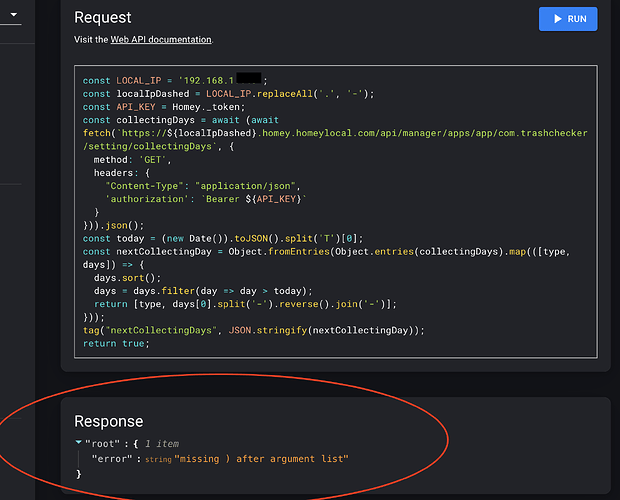

Hi!
Tried to copy-paste the script to Homey but got an error. I’ve replaced the IP-address with my own static IP-address.
Any idea why it doesn’t accepts the script?
it is a script for HomeyScript, not for the Web API Playground.

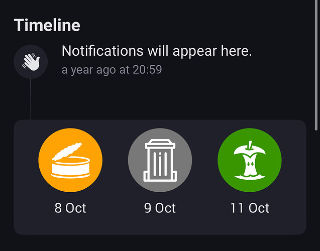

Quite an old topic, but for the ones interested. Homey Dashboard is now live and there is a native Widget available :slight_smile:
Please provide feedback either in the Trashcan App topic ([APP][Pro] Trashcan Reminder 2.0) or on GitHub (GitHub - robertraaijmakers/com.trashchecker: Trashcan Reminder 2.0 is an app for Homey (Home Automation Hub) and gives you the ability to get notifications when your trash is being collected.).
Unfortunately, this again gives only yesterday/today/tomorrow; but not “on 14 oktober (in 10 days)”
Do you set your trash on the street in two weeks?
With this widget you are able to see all next trash dates for every type. So if GFT is collected in 14 days, you will see it in the widget :wink: if it collected today and in 14 days, you will only see today. But I guess that is the most important right?
This is indeed what i am looking for. So the app now supports this? Or just the new widget for the new dashboard?
The dashboard widget supports this now indeed! The data has always been available in the app, so you can retrieve it (just as the new widget does). But then you need to create some virtual devices somehow (some options are described above in this thread). However they are all quite complex.
Think the new widget will serve its purpose. And if someone with some UI/UX skills comes along I might make some variants.
