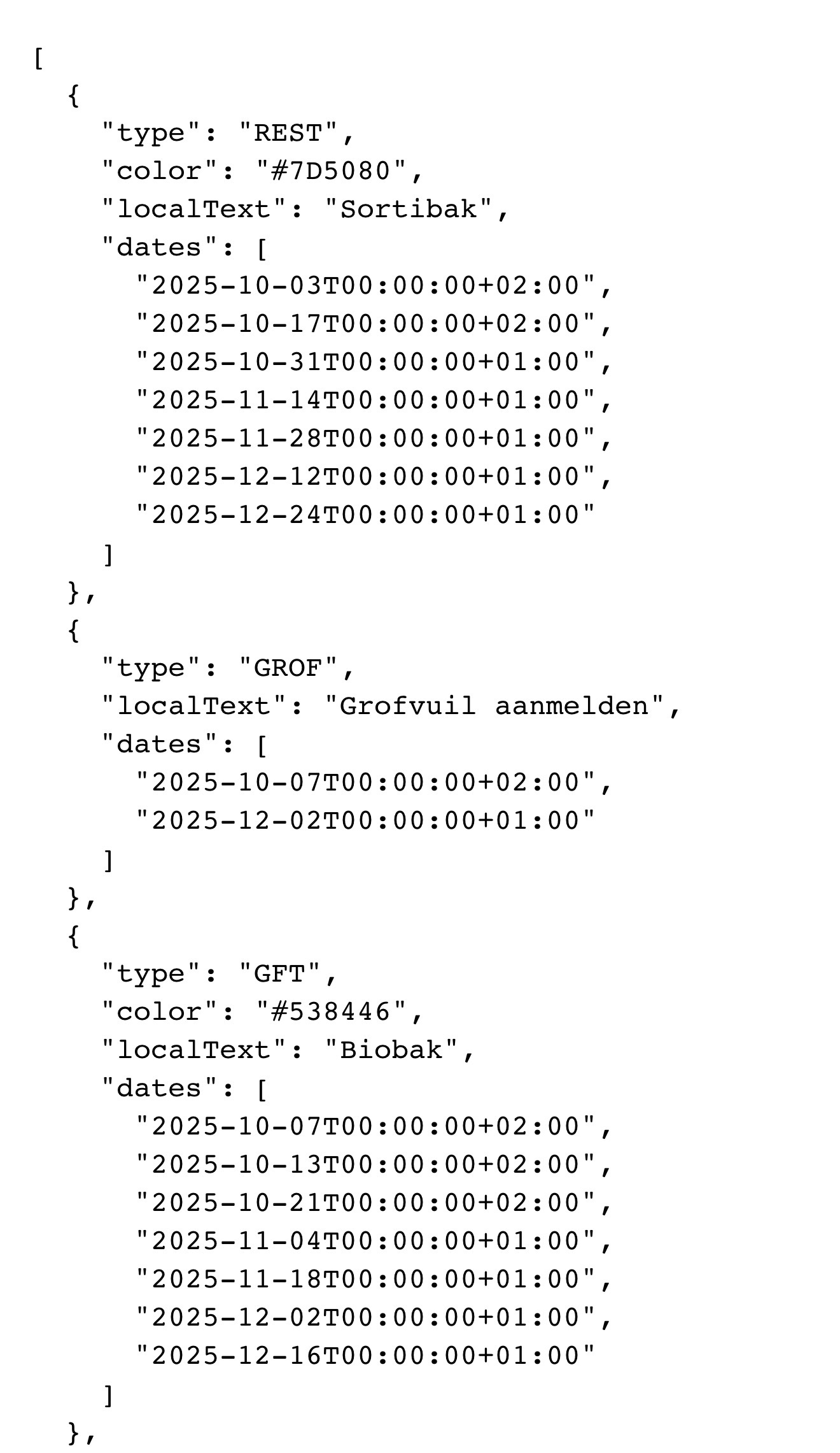

Can you drop a screenshot of how they are? Is there maybe a timezone included or something? Think it might have to do something with time conversion of the dates there are correctly shown.
Yes, ofcourse!
Ah, there we go, +02 and +01. Will need to filter those out somehow for Omrin… Will try to do that on Sunday!
