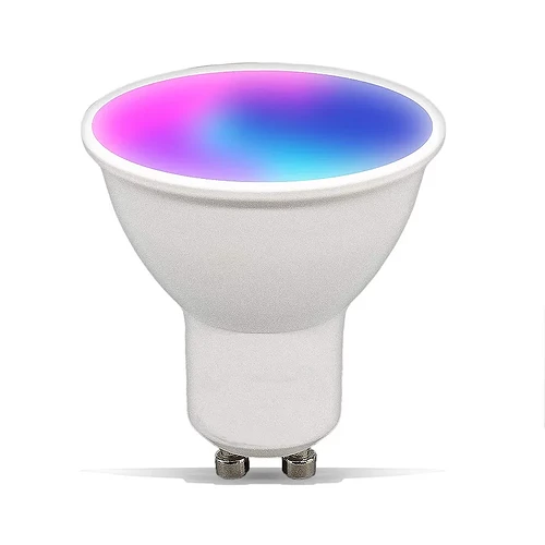

hi @spkesDE
i have a problem while adding a tasmoto rgb led.
I can add any device I want except this Athom GU10 lamp.
when the config is like this:
GPIO # Component
GPIO00 None
GPIO01 None
GPIO02 None
GPIO03 None
GPIO04 PWM 1
GPIO05 PWM 4
GPIO09 None
GPIO10 None
GPIO12 PWM 2
GPIO13 PWM 5
GPIO14 PWM 3
GPIO15 None
GPIO16 None
GPIO17 None
it is not possible to add the lamp. when I remove now one GPIO config and set it to none, doesn’t matter which one, it will be found. Do you have a solution for my problem?
it is this kind of LED. Thanks a lot
on my homey pro 2019, when I added similar lamps a year ago, in the past everything was working fine with these kind of bulbs.
i also tried older versions of tasmota (tested 10-13) but that didn’t effect the pairing process…
Could you restart the app, try to pair the bulb with and without the gpio config and then send a diagnostics report?
