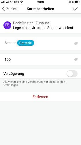

In the meantime, I tried to set up a virtual device, trying to set it with flows. However, I am not able to write any values to this device, at least not my way:
