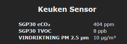

Hi all,
I’m using this app to log data from some sensors. It works pretty good, devices are found and show readings. However, I’ve noticed that PM2.5 readings from Ikea Vindriktning sensor and PMS5003 sensors are displayed wrongly as ppd instead of µg/m³. This leads to Homey not being able to make a graph, because graphing isn’t supported for ppd values.
Tasmota view:
Homey view:
Device capabilities:
\lib\sensors.js holds the default unit value for each sensor type, so I can make a pull request to update it so it matches the true unit notation of the sensor and it will become µg/m³.
However, maybe the right/easiest way would be that Homey would support graphing of ppd and ppb values.
@robertklep notified me of the fact that this app doesn’t seem to have the capabilities set up in the right way: measure_particulate_matter.pm2_5.{sensor} intead of measure_pm25

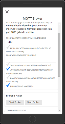

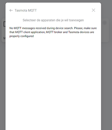

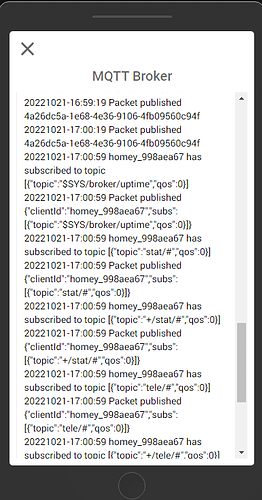

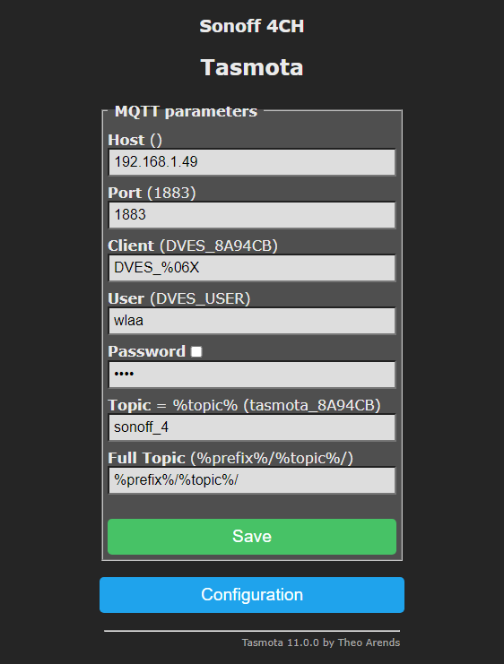

Hi I need some help. I never had any problems with my sonoff C4H installing it last year. everyting was working smooth. But for some reason it’s broke. I tried reinstall etc.
so first i configured the MQTT Broker.If I dont check the skip user auth it keeps saying not authorized
used telnet to verify 1883
I got lots of data back so i assume its right
Then i configured the client
broker status is connected in the logs
when i check the device console
I keep getting the RC -2 (client id rejected)
while adding device i get this
what am i doing wrong
thanks in advance
You’re setting a username and password in the Tasmota MQTT settings, but your broker looks like it’s configured to run without user credentials, perhaps that’s causing an issue?

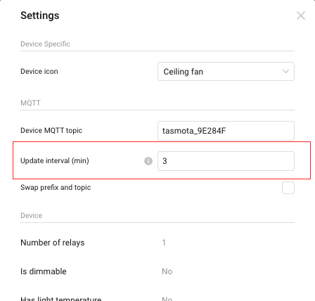

Hi All.
I 've this sonoff TH10 running on tasmota, is there a way adjust the update interval to 1min as default 3min seems very lagging for humidity and temperature.
Screenshot 2022-12-20 at 9.12.45 PM
