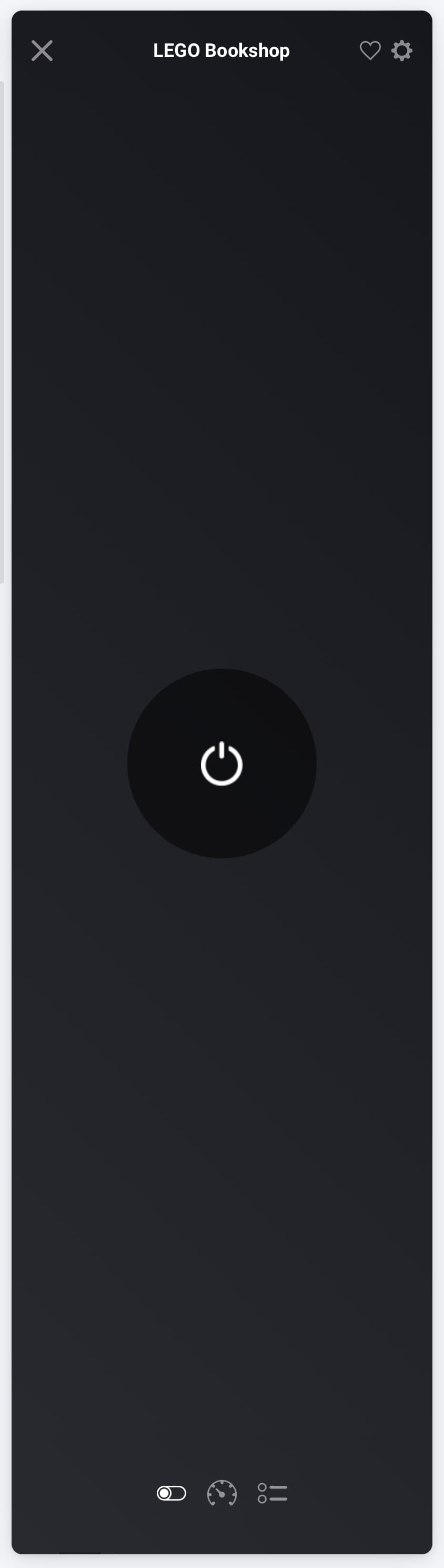

I’m running v0.10.3 on my old Homey Pro. There it shows up like this:
While the updated app (v0.11.2) doesn’t show the option to switch between the relays:

Ah, i know why. Will fix it.
Should be fixed.
