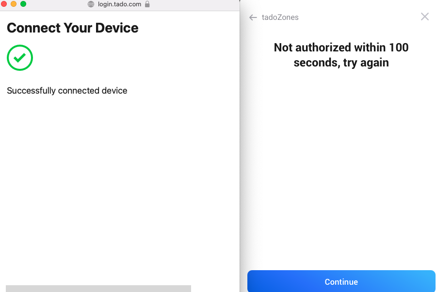

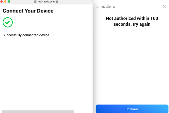

Hi @Martin_Verbeek , I am having troubles adding the Home device again.
My steps were:
  1. Deleted the Home device
  2. Updated the app from 5.x to the latest test version
  3. When I’m trying to add the Home device, the process does not recognize that I authenticated on the tado side
Could you please kindly look into it?
Just pushed an update, can you check if this solves your issue?
No luck.
The difference is that now I got the error in shorter time.
Can you go to the app settings and PM me the log.
To be sure, after the connected message, you do not do anything and wait for the spinner to be finished?
Forgot to restart the app, works again!
