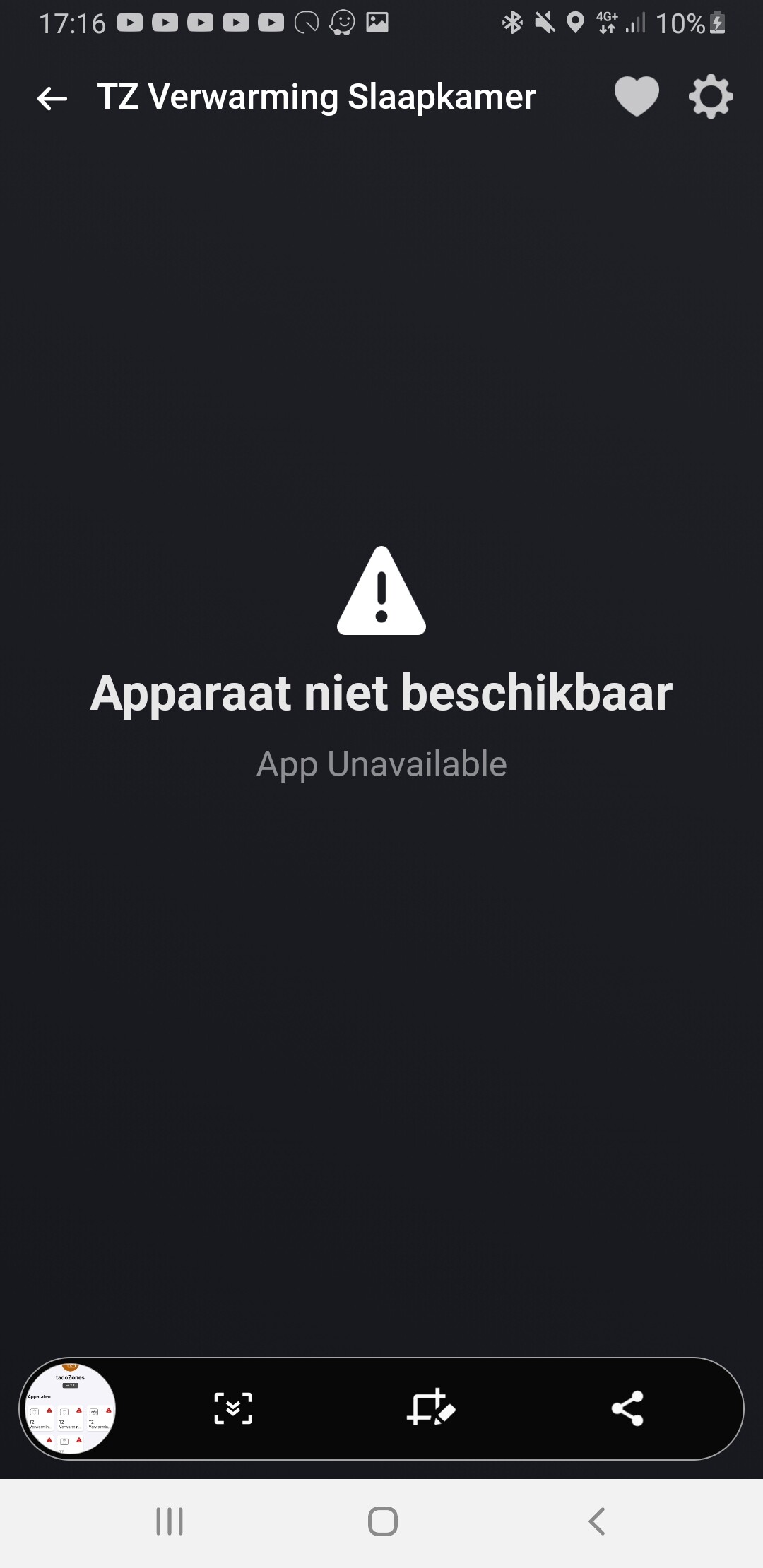

Hi there, the devices are unavailable after a couple of hours or so. A reinstall from hcs works, a restart doesn’t. Any idea how to solve this?

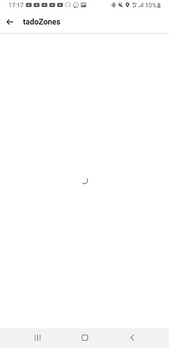

It doesn’t load.
After a reinstall

A reinstall (over the old app), will make the devices available again, but not for long

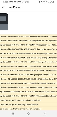

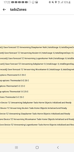

It is running fine now with me, but I do see errors in the app log. Unfortunately I cannot copy these errors to a clipboard and add them here. This is a bit weird that normal copy/past is not working
Diagnostic report to developer is also not possible, because it is not installed from the Athom store I suppose.
I managed to use Browser inspection and to filter the log part out of the webpage:
