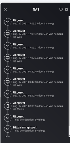

I installed the app and has connected the NAS. Got at first data in retern. But after 10 minutes the app was swithched off by Synology. updated Data is not updated to actual numbers.

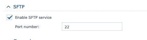

New app update (test: 1.7.0.):
  • NEW: add file upload via SFTP (port 22)
The file will upload to the home folder of the logged in user. In a folder named ‘homey-synology’
Note: Make sure to enable SFTP in your Synology to use this function. > Control panel > File services > FTP > Enable SFTP (port 22 recommended)

Same issues over here. In Homey the app shows that my Synology is turned off and (within 2 minutes) is turned on. In reality the Synology isn’t down. I couldn’t find a solution myself. Any idea what could be wrong?

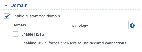

@Walter_vande_kerkhof Probably a IP issue. Can you try to give your NAS a fixed ip adress or use a alias.
Alias you can do like so:
Control Panel > Network > DSM settings > Domain
Then if you browse to synology.local you get your DSM.
In Homey change the IP you filled in to synology.local. That will probably resolve things.
What is happening:
When your NAS turns off another device is taking that IP. Then when it’s started again it cannot get the same IP and shows as offline.
