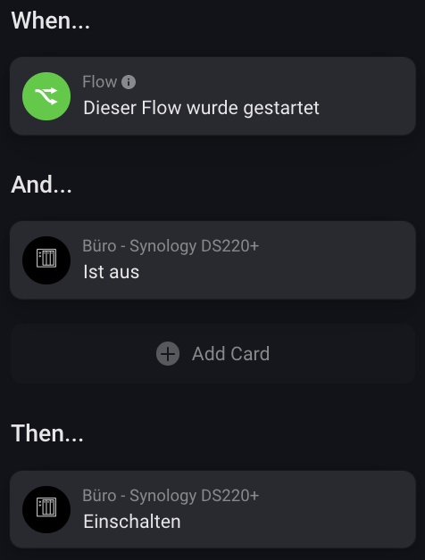

This morning I didn’t touch the DS or the DS tile in Homey. The DS was turned on/should turn on via flow.
The DS turns off automatically only when the DS is started with this flow:
Translation:
When…
– This flow is started
And…
– The DS is turned off
Then…
– Turn on DS
If the DS is turned on with the tile in Homey, the DS remains turned on.
