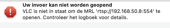

First attempt failed with this error:

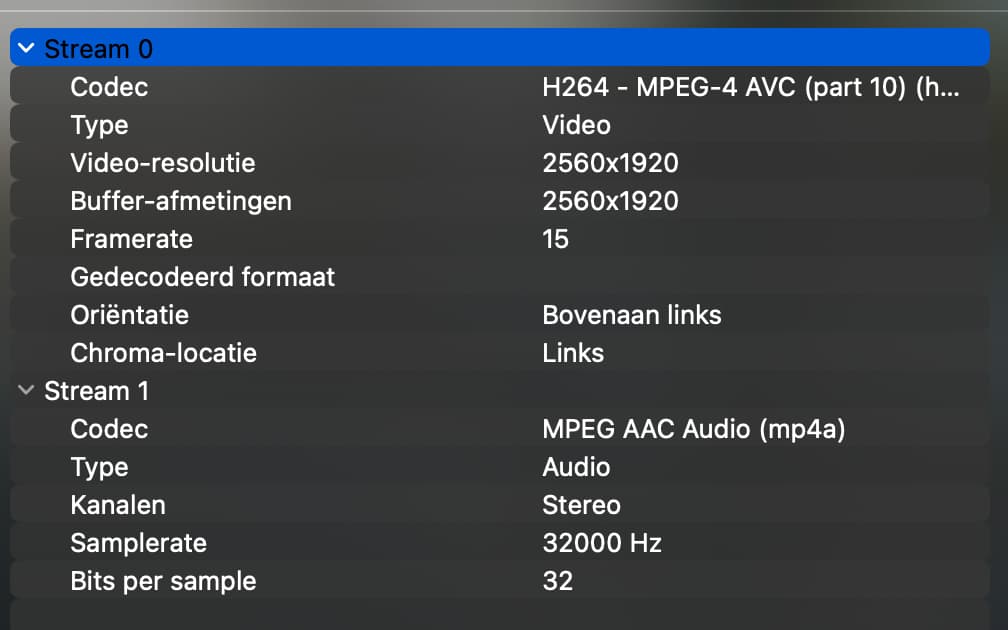

Than I tried exactly the same again (opening the url with Chrome browser, than being suggested opening the stream with VLC) and this time I was asked to enter credentials and… the stream showed up!
This is the screenshot:
Unfortunately, trying the same again after a few minutes gives:
