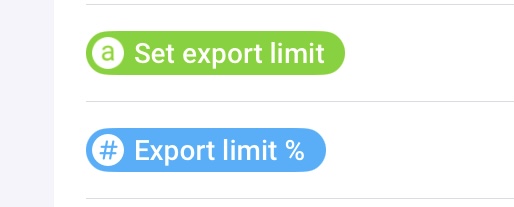

When selecting from device the device named growatt you don’t have the flowchards enable export limitation and enable/disable limitation
The other two selectable growatt devices with the +battery in the name do have these.
These are not specific to the battery you can connect , so they should / would also be available for the normal growatt inverter missing the +battery in the name.
I have tested this with the +battery version and it works like a charm . But giving me all kinds of issues because I’m getting empty battery notifications and empty battery report in homey energie dashboard . That’s logical ofc because there is no battery connected and I have selected the +bat while I should have sledged just growatt
yes I understand but I don’t have a growatt inverter so I want you to test it out with Modbus App for Homey | Homey what works so I can add it to the normal growatt device.
or what flow action of battery device works for you so I can copy that to the normal device.
A now I get it . I will test every flow action I can find in the battery+ tomorrow that could work on the none battery once there is sun and I’ll report back. I just looked and tested the set export limitation % and the enable and disable export limitation action card
Will do the others to

The cards that work for the non battery
And :
Then:
And the device variable tags:
