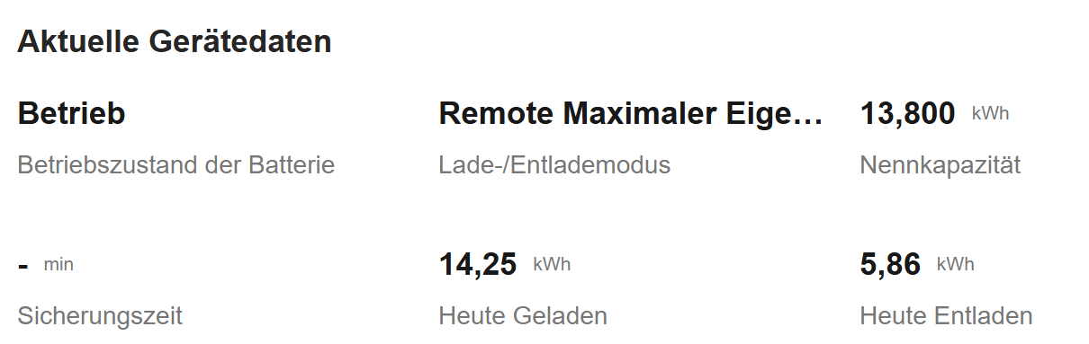

thx - here’s the result:
they are corresponding with the portal values
The total charge values are “”
according to the portal i can only find one info 461,31 (which is the “total energy discharged”)
if it helps - diagnostic: dfaaceca-12e3-4f9e-af78-1336eb53d116
found it , it is 4 bytes, let me fix this.
