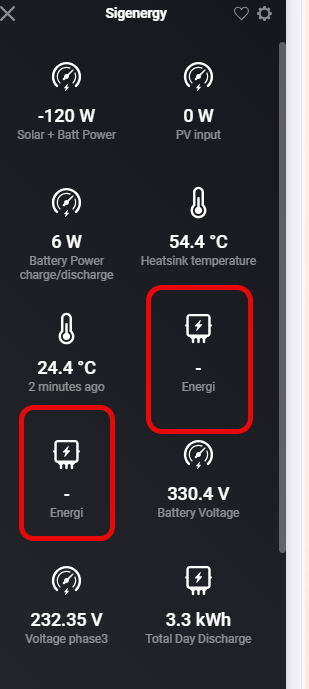

The two Energy data elements is empty and does not provide any data! what is the intention with these, what registers you try to read?

@Edwin_Biemond I mean these two are never updated
can you remove and add it again. you have an old version. sigenergy does not do daily and total pv on modbus
