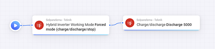

Still testing my flows, it looks like setting the “Charge/Discharge” to 5000 sets the battery to discharge at 5000w for a minute or two, then it stops.
I would like to stop it myself given certain conditions. Is there anything else that’s stopping it now? I have no other flows or automations running on the inverter.
Thank you so much!
Mats
Don’t mind me, I figured it out :slight_smile:
Sungrow requires a start and stop time in the settings for when discharging is allowed.
